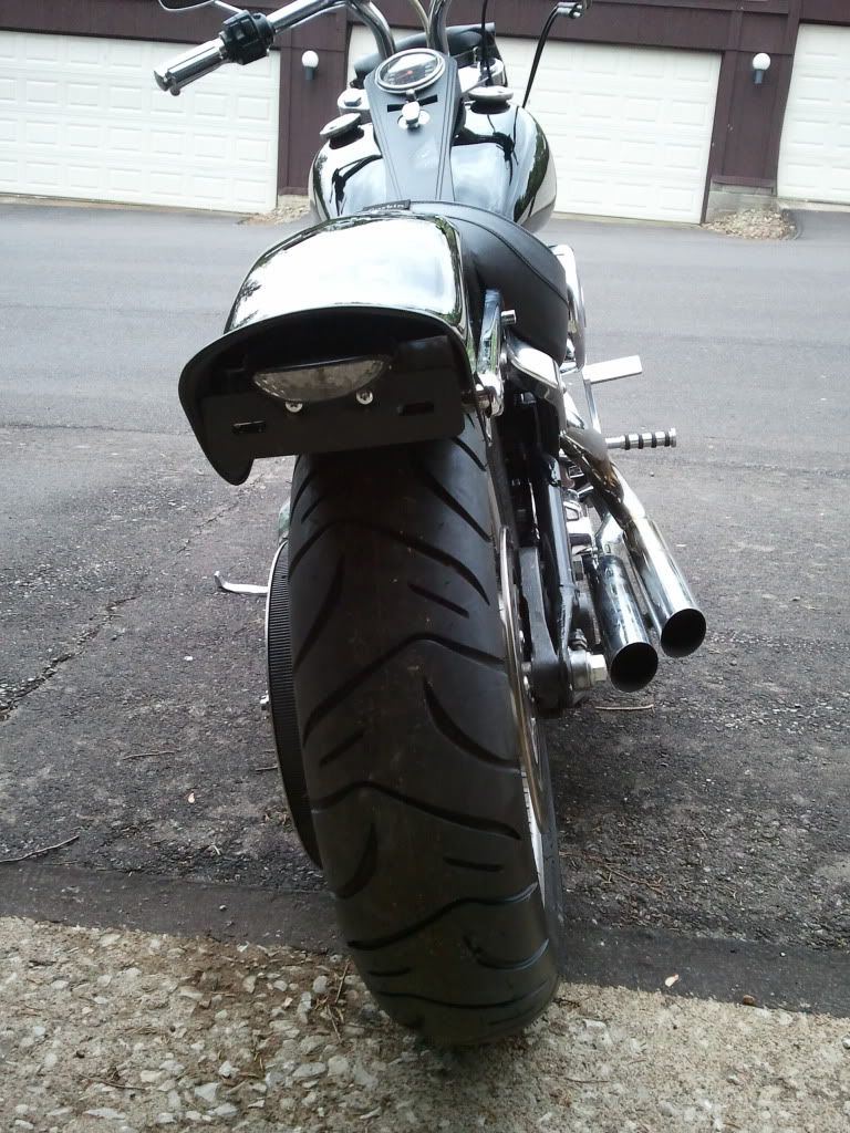

Old Dec 18, 2017 | 08:47 PM
langwilliams's Avatar
langwilliams
Joined: Jul 2010
Posts: 3,830
Likes: 302
From: Lorain Ohio
this is a 170 wide on a 17x4.25 deuce wheel. I had to go to a skinny belt an pulley to make it all fit.
