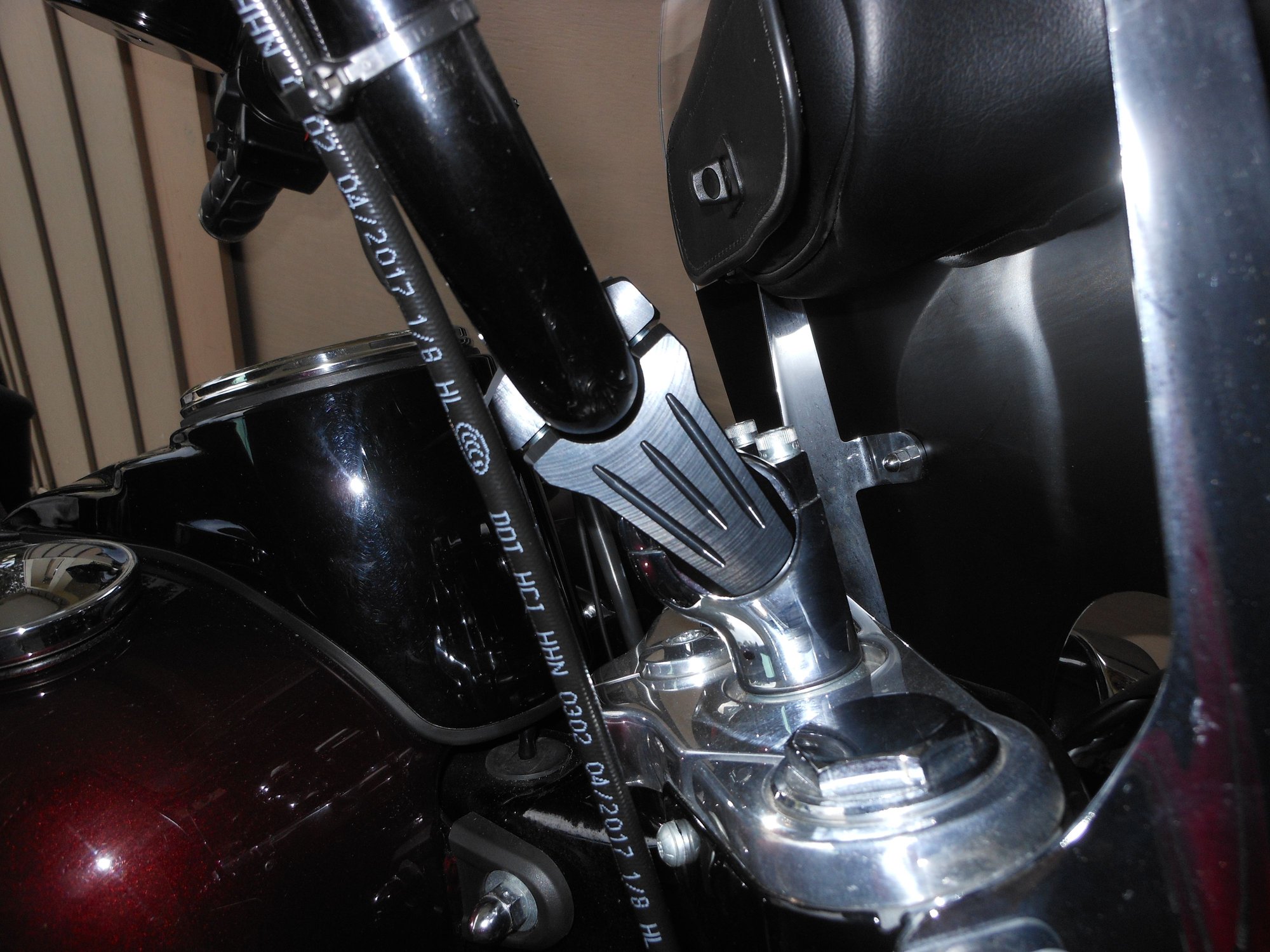

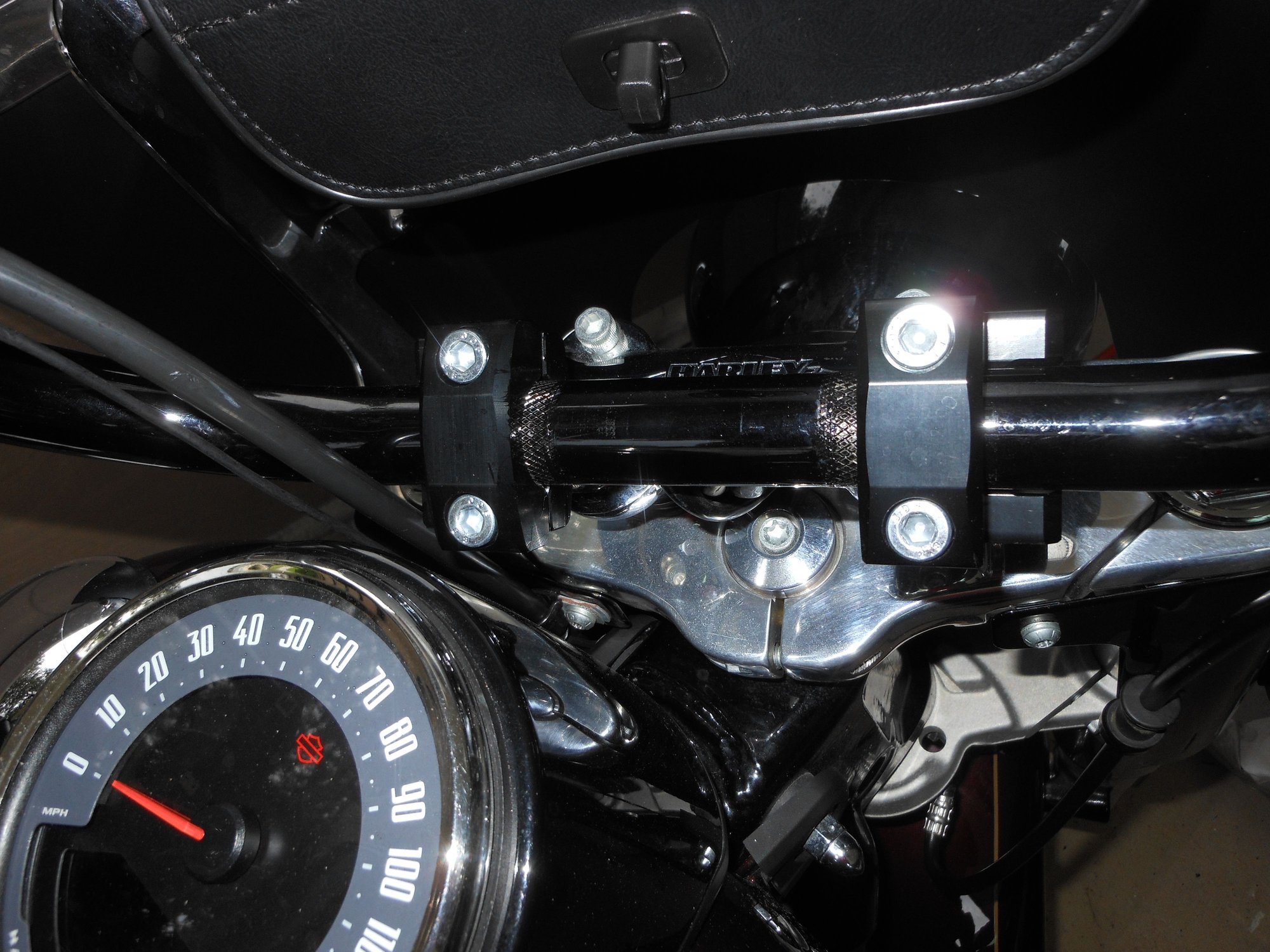

So what height risers did you end up installing? 4”? Did you have to extend cables?
if possible still would like to see some pix if available. How much was labor for dealer job?

Yes they are called 4" risers and no, I did not have to extend any wires or cables. There was just enough wire length tucked up into the HB's to allow me to install the risers with out even disconnecting anything...PITA but doable.
I bought the mono shock, the front lowereing kit and the jiffy stand from the H-D online store (could have save some money if I had used Surdyke) and supplied the front kit and jiffy stand to the dealer to do the install along with my 1k service. If I remember correctly, including the service it was just over $600 all together, so you will need to do the math.

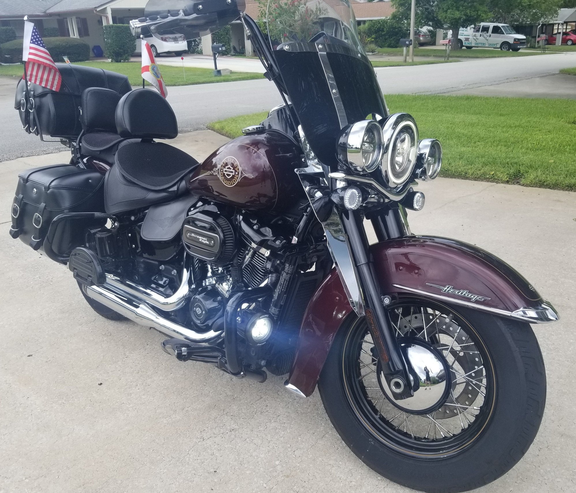

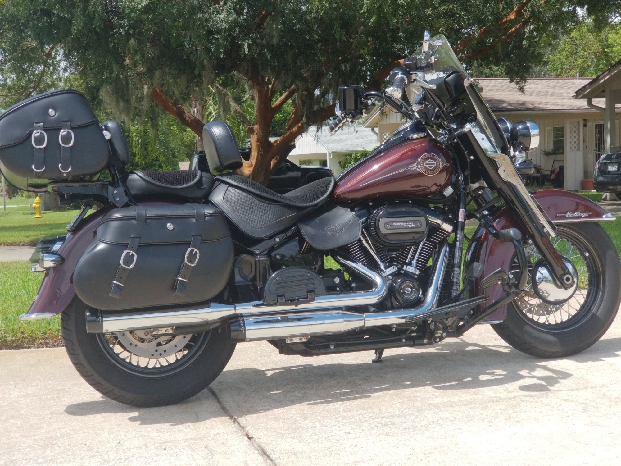

This Pic is from 9/18
This Pic from 8/19...lots of things added.
FWIW, I hated the OEM saddlebags from day one. I replaced them with saddlebags and tourbag from LeatherPro.
