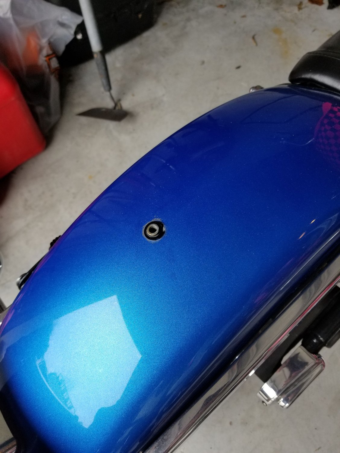

I had a very flush chrome cap thay screwed into my passenger seat mount screw that rattled out. I cant remember where i got it but i need another one. It screwed in by hand , was completely smooth and nearly flush to the fender. HD makes one but it kindof sucks because it sticks out about 1/2 an inch. Thanks in advance for your help and suggestions !

Google "domed mirror screw" and search for what you want.

1/4 20 button head, Lowes, Homedepot, Kids toy box, Use blue loctite , cause they vibrate loose.

Not sure about a flush screw cap but here's links to thumb screws.
Link to stainless screw:
Amazon Amazon
Link to black screw:
Amazon Amazon
Link to brass screw:
Amazon Amazon
...+1

I used a nylon bolt from Lowe's. It will scratch nuttin.
