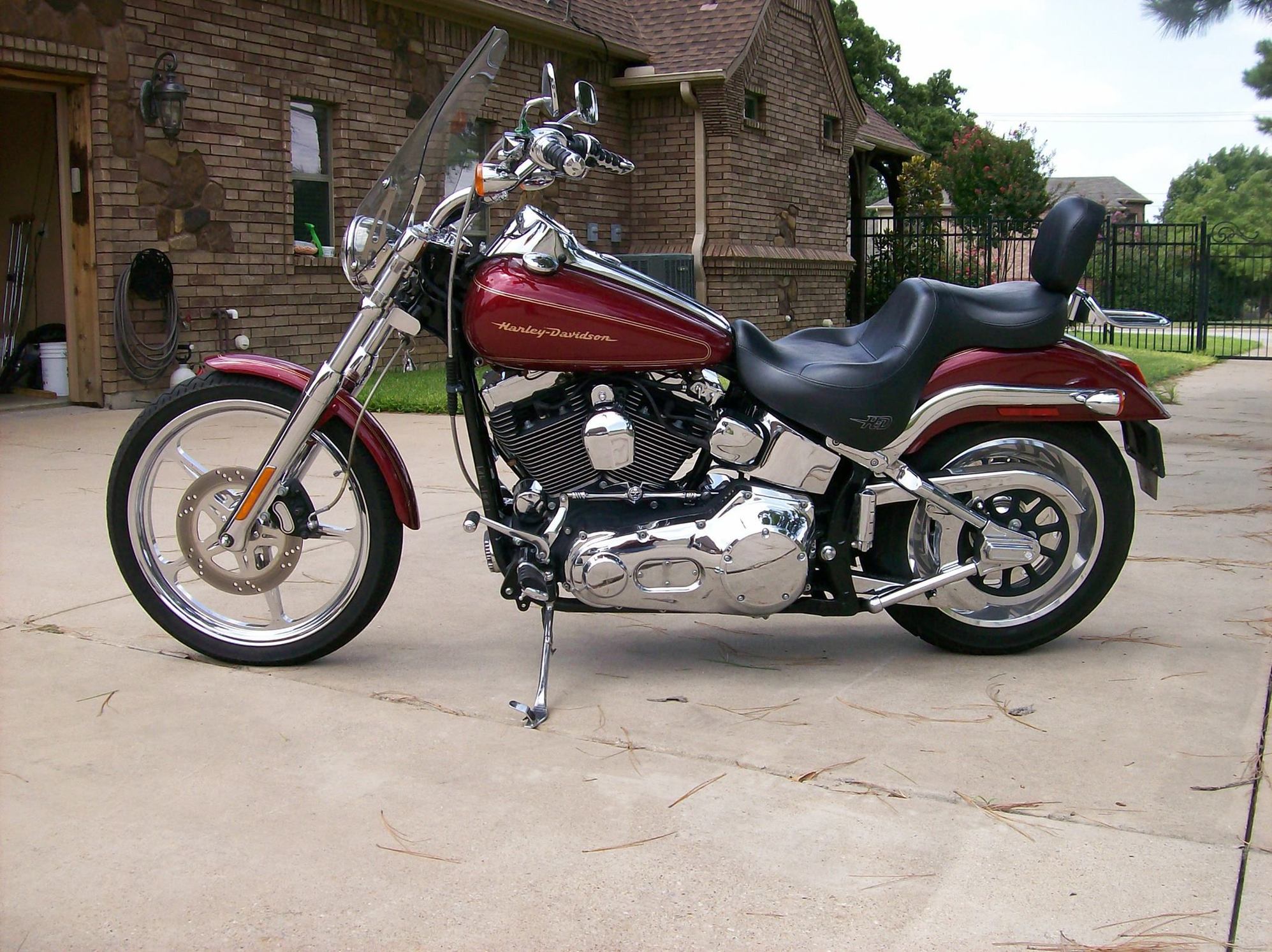

I have owned three Deuces, 2001,2003, and now a 2005. Love my Deuce. Each of my Deuces I have done the 200/55/17 rear tire. I didn't want to spend $1,500 to $2,500 for the kit, SO! I took the outer and inner primary covers off. Removed clutch basket and belt along with rear wheel. Removed swing arm and took it to a weld shop and explained I needed the swing arm expanded 3/4 of an inch on the pulley side. So, they cut the swing arm and offset it and welded it back together, ground it along with polishing it. I took it then and had it powder coated. the total on the swing arm was $100. I looked on Craigs list and found a new take off from a 2010 Fat Boy rear wheel, pulley, and rotor. The wheel was a 6" wide with the Dunlop 200/55/17 tire. I hand polished the wheel and pulley to a mirror finish. (By the way I payed $100 for the wheel combination) I took the rotor off and sanded it with 220 then with 400. Bought the polishing compound sticks from Home Depot along with purchasing 4" felt pads on Ebay for my grinder and achieved a mirror finish. I bought a new 20mm 133 tooth Harley (GATES) belt. The wheel had 1" bearings so I got on Ebay and found the 1" to 3/4" reducer bushings. (A 1" axle won't work on the stock swing arm.) Now in order for the tire to work with fender you have to take the struts off, In doing so you will find on the inside of the fender has a bracket on each side for hard bag mounting. Remove and throw away. Now the four bolts holding the fender on, reverse these and reinstall. Make sure wheel pulley and rotor are torqued. Put struts back on. I purchase a used 13" x 3/4" axle Ebay. Install new belt to transmission out put pulley. Reassemble clutch, chain, tension-er, inner and outer primary covers, gaskets and torque. I installed the modified swing arm. I had to measure and cut new spacers so the tire was exactly in the center of the fender and swing arm. Normally the Deuce takes a 132 tooth belt. I installed the 133 so the tire would set back more to fill the gap on the fender. I also used longer wheel adjustment bolts to achieve the tire set back. I gone through this process on three Deuces, and it looks BAD ***!!! I spent around $600 for these results. I hope this may help someone achieve the same.
