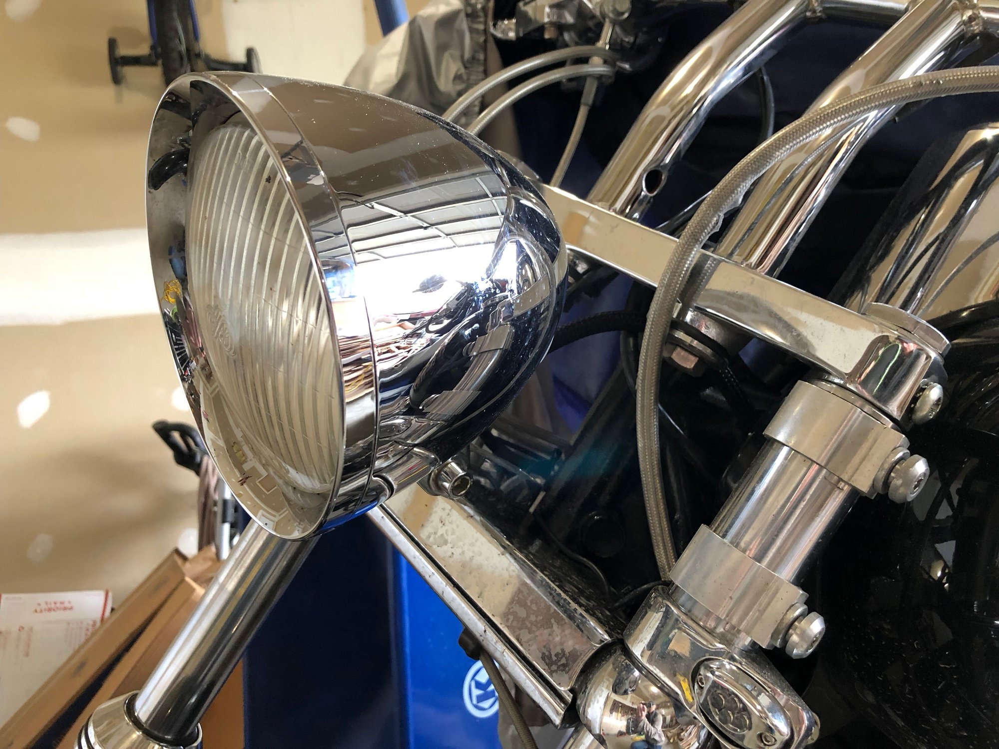

The first photo shows the headlights I have. Existing, harley, sunpie (left to right). Take a look at the width of the "seating surface" for the headlight and you will see the harley and sunpie are nearly a 1/4 inch thicker.
The second photo is the existing housing/bucket on the bike. I dig the looks and would like to find something like it that fits an OEM style (width) headlight. I suspect the JW Speaker has the same width "seating surface" as the harley and sunpie, and therefore would not fit this housing/bucket.

If the bulb lip is to thick for the bucket you need a new bucket. Do NOT dremel the lip, you'll break the seal and get water in the bulb. Maybe shorting the transformer or whatever is in there.

Roger that RANGER73, I agree 100%
There are SO many options out there for headlight housings/buckets, but most look like they are poor quality or won't fit the OEM lip...
...anyone have any tips on finding a good looking non-stock bucket that would work for a JW Speaker?
Thoughts or experience on a 6-inch LED light bar?

langwilliams - no, I can't find any identifying info on the housing/bucket...just a silly looking motorcycle figure on the center of the lens

I have a cobra 2 headlight on my 06 Softail Standard. The sunpie fits great in there. I think I got it at Dennis Kirk or J&P

Update to post #6 - the housing/bucket on the bike now is from DNA Cycle Products (link below)
DNA CYCLE PRODUCTS HEADLIGHTS
Anyone have input on the DNA LED's?

The 5 3/4 tri-bar looks like the Cobra 2. They also have a ring for LED lamps which may be what you need for your existing bucket

I went to the stealer and got a Springer Bucket. There's 3 spring wires type tension that hold the bulb in the ring as opposed to the back part. Plus with the built in visor it hides the lip the sticks out with the stock ring.
