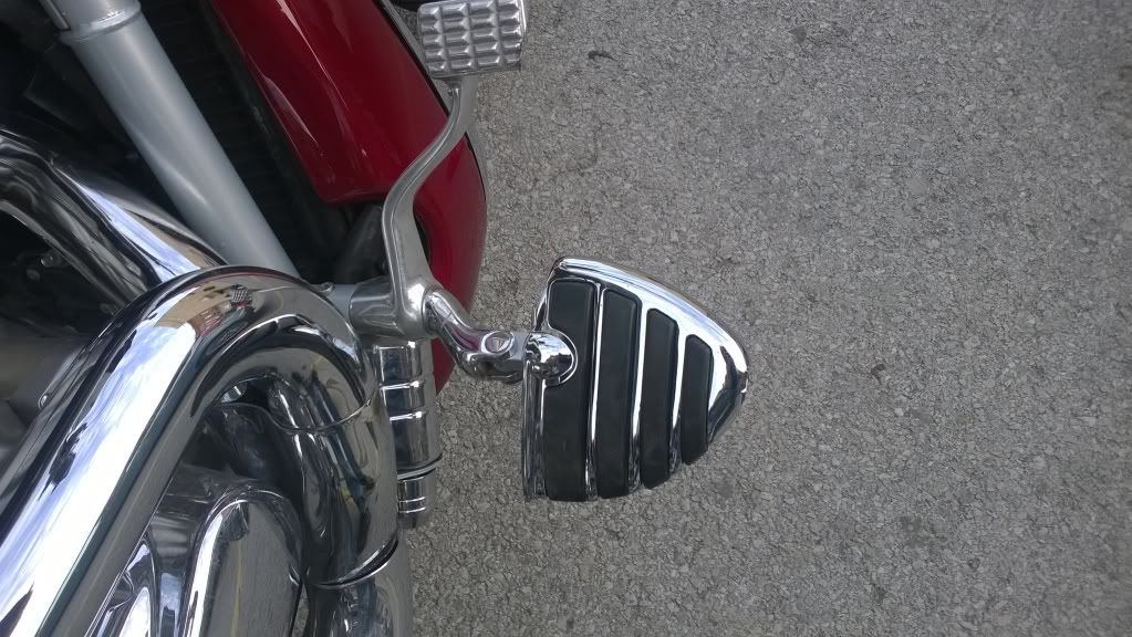

handlebars can generally be made to fit...there may not be a list of bolt on bars but if you find a set of bars you like you can make them work with new throttle cables an clutch cable an extending the wiring. you might want to try a reach seat that pushes you forward an is thin to help you plant your feet. the blackline has the same rear fender as the slim so seats for the slim will fit. I had a blackline seat on my slim for a while so it works. the bars look like a unique design. my guess is with regular risers you can use regular bars that fit you. I couldn't find anything on an offset kit for the pegs, I put a kit on my V rod an that really helped. I also used some mini footboards for better support
here's the offset an iso wing pegs

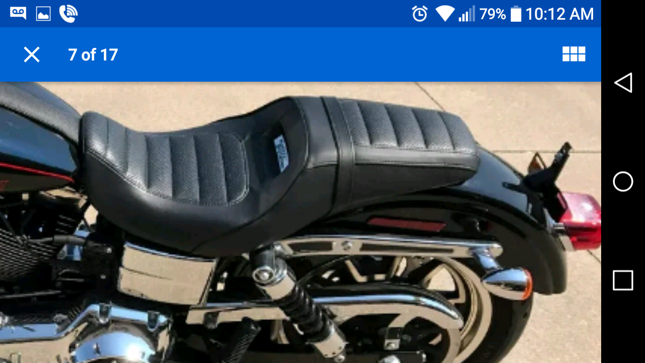

If I could make the seat of a low rider fit that would be awesome because that seat has extra padding to push me forward.

Default Crap the low rider is a Dyna
I was hoping this seat would help but doesnt seem that different and I dont think it would push me forward if I can even fit it.
