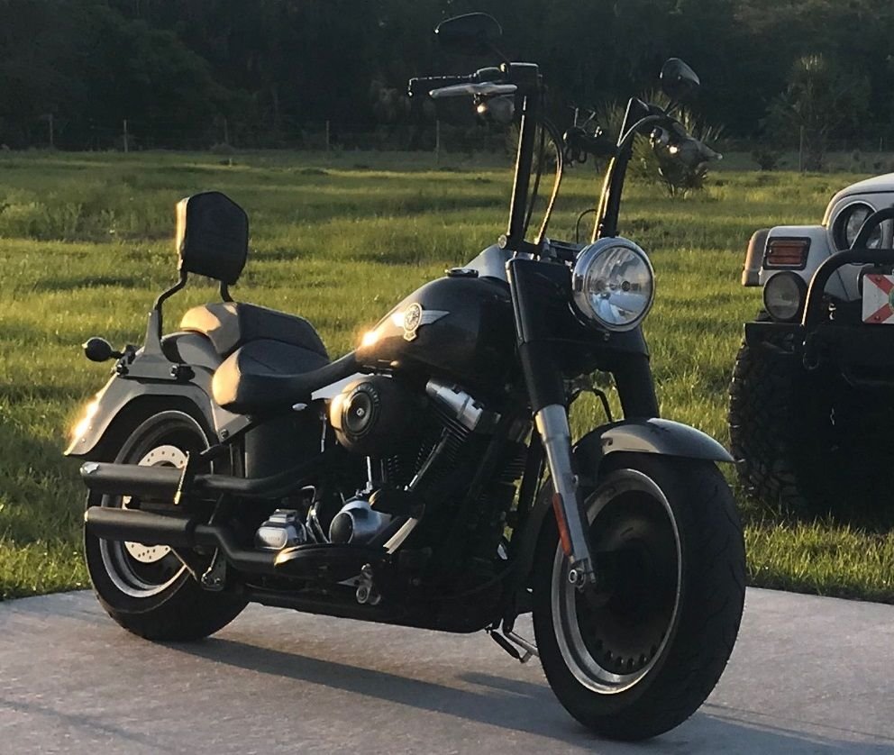

I'm Jason. I live in Tampa, FL. I just purchased my first Harley after looking for about a year. I have a 2015 Fat Boy. She came already with the Chiseled Harley Z bars and Vance and Hines pipes. I love it.
