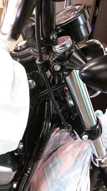

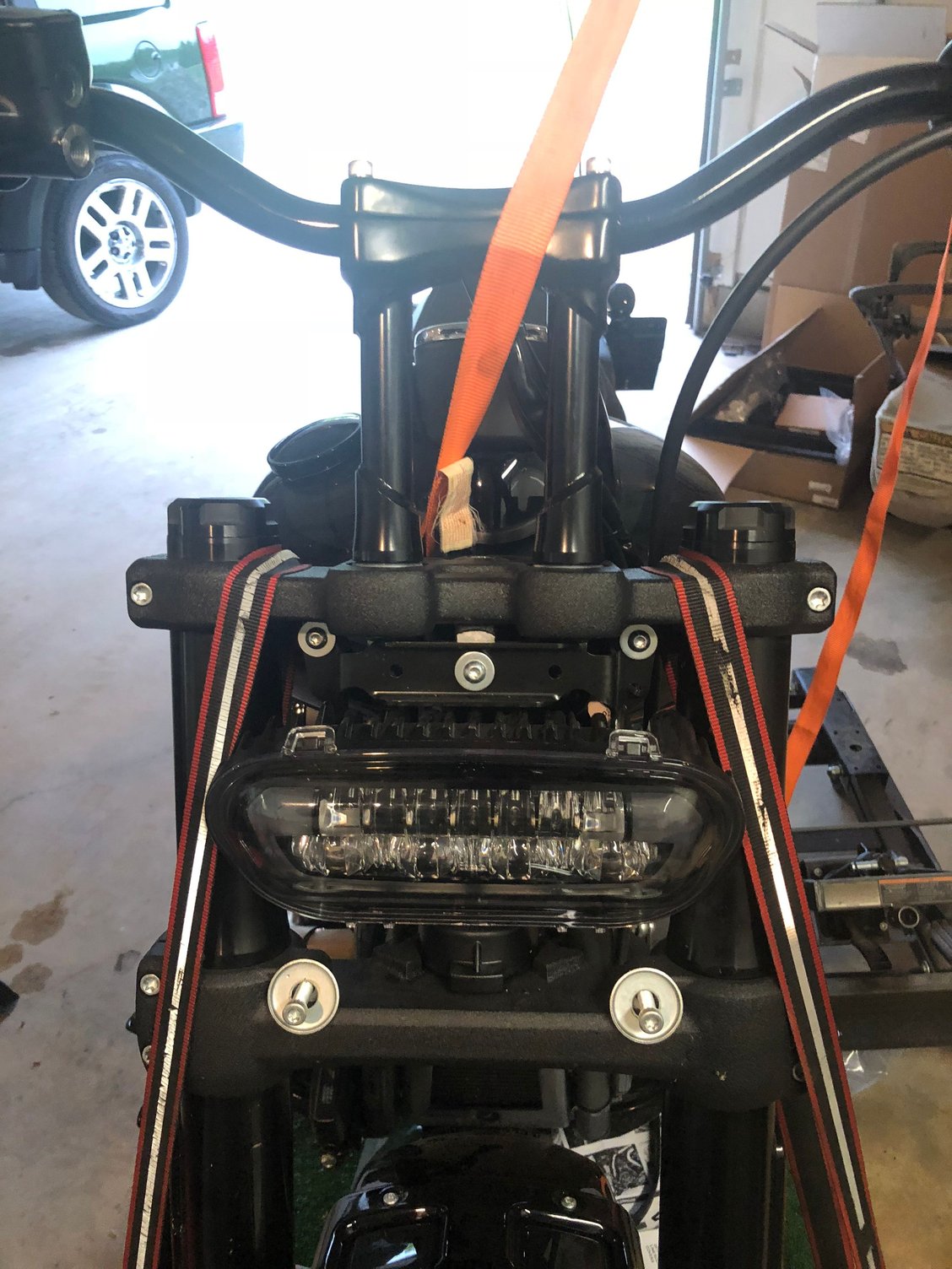

So, I've purchased my 18' FXFB. Installed exhaust, risers, and bars. Now, when I went to attached Harleys recommended extended brake line cable to reach added rise, I came to a problem. In the picture, you'll see the master cylinder line to caliper line. Notice they are all fused together so you can extend lines without replacing all of the (stupid design). I've Spoken with Michigan dealers (where I live) and California Dealers, all of them say Harley has no replacements or add on's for the NON-ABS bikes. Doe's anyone know how I can extend these lines! So frustrating.

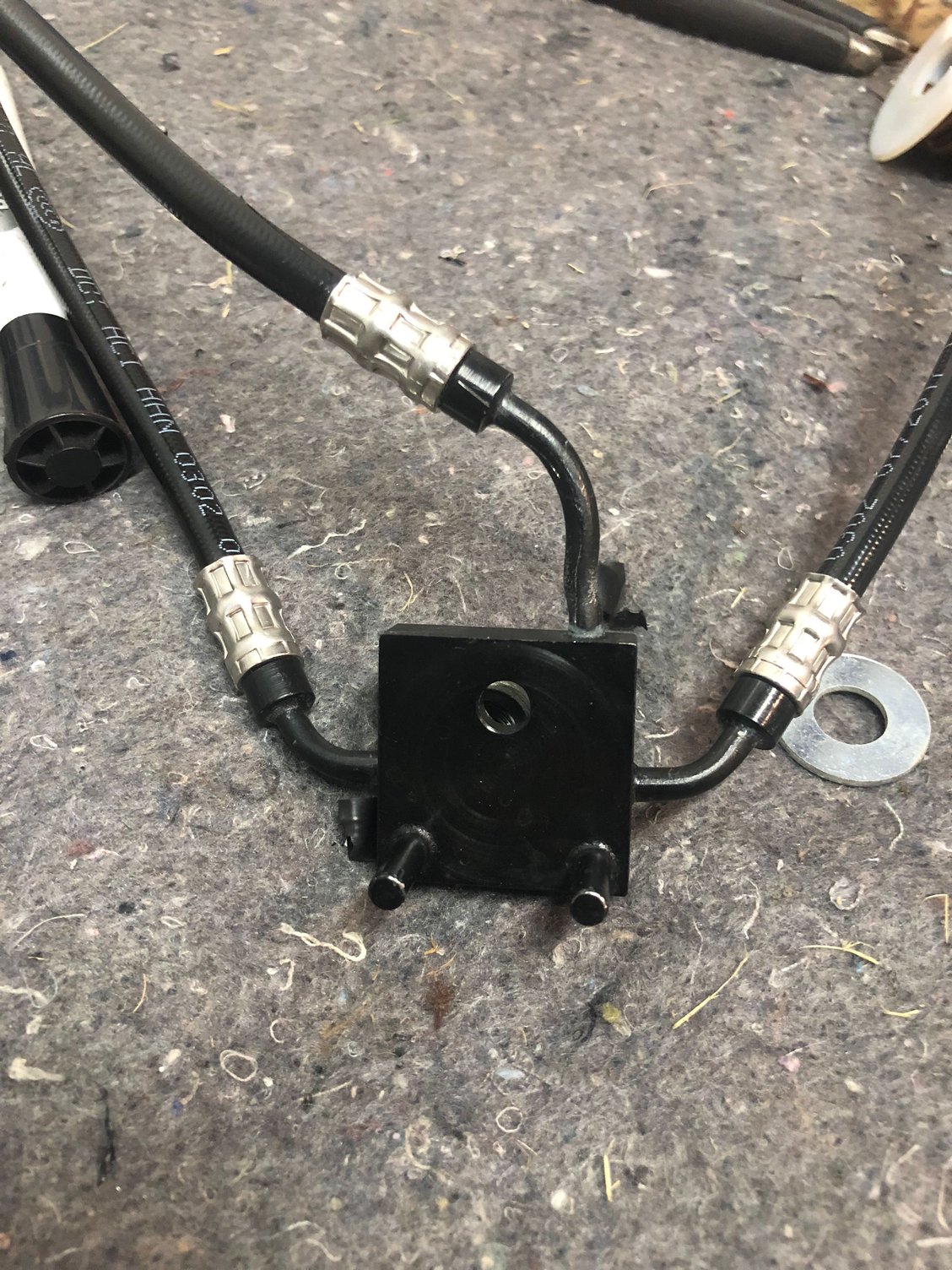

I ended up cobbling lines, and splitter to achieve this. Let me know if you need exacts. I can take pics and provide links!

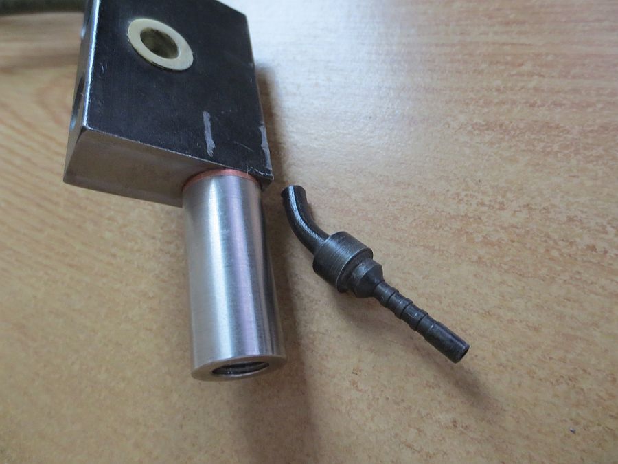

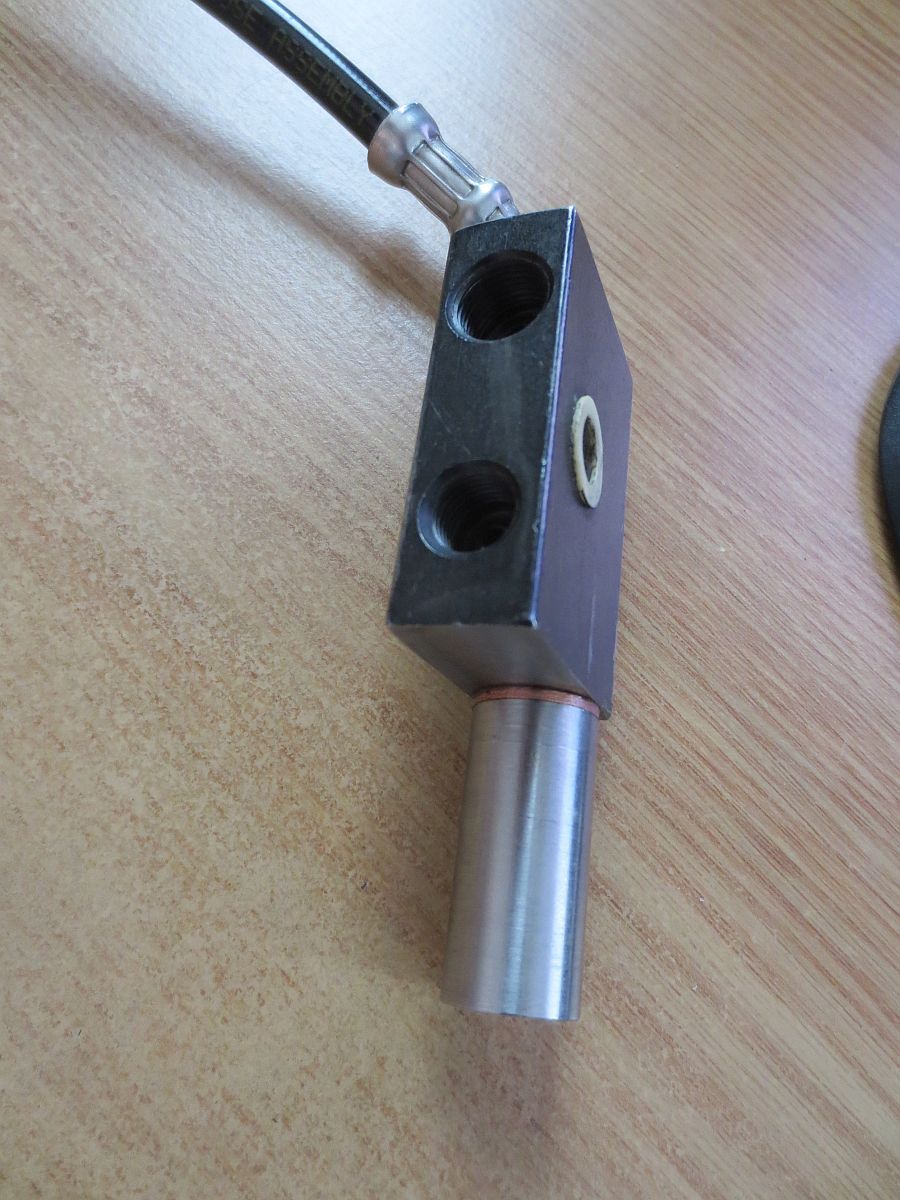

Just drill and tap, done it many times now, this is one of my first setups.
This one I did with an extension and you turn the banjo bolt in the extention and use whatever line you want/need. The next "generation" I made are the banjo
bolt direct ikt oem piece and then I use a 90° mounting point on the brake line.

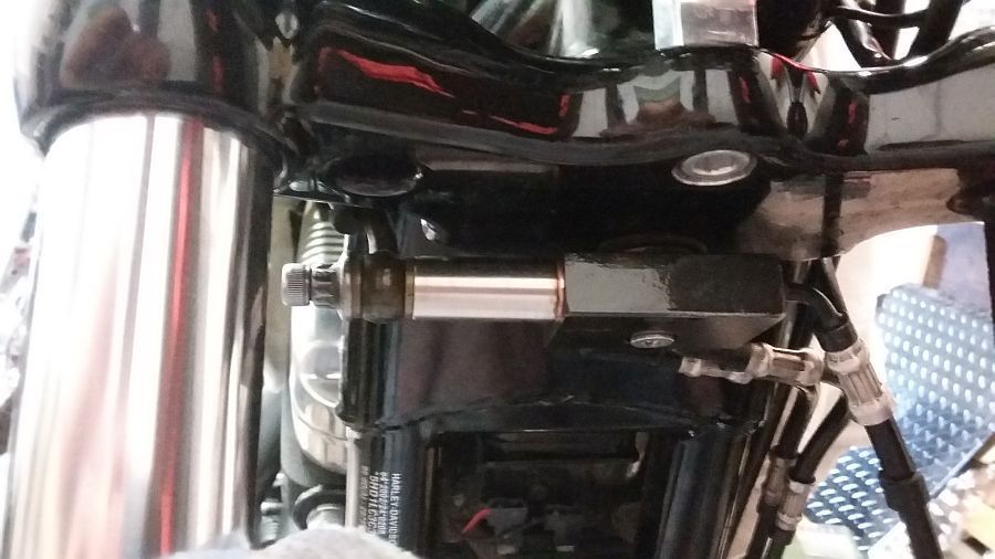

Here is the piece mounted, in this case it is on a 48 but they are all the same setup and can be done with or without abs system.
