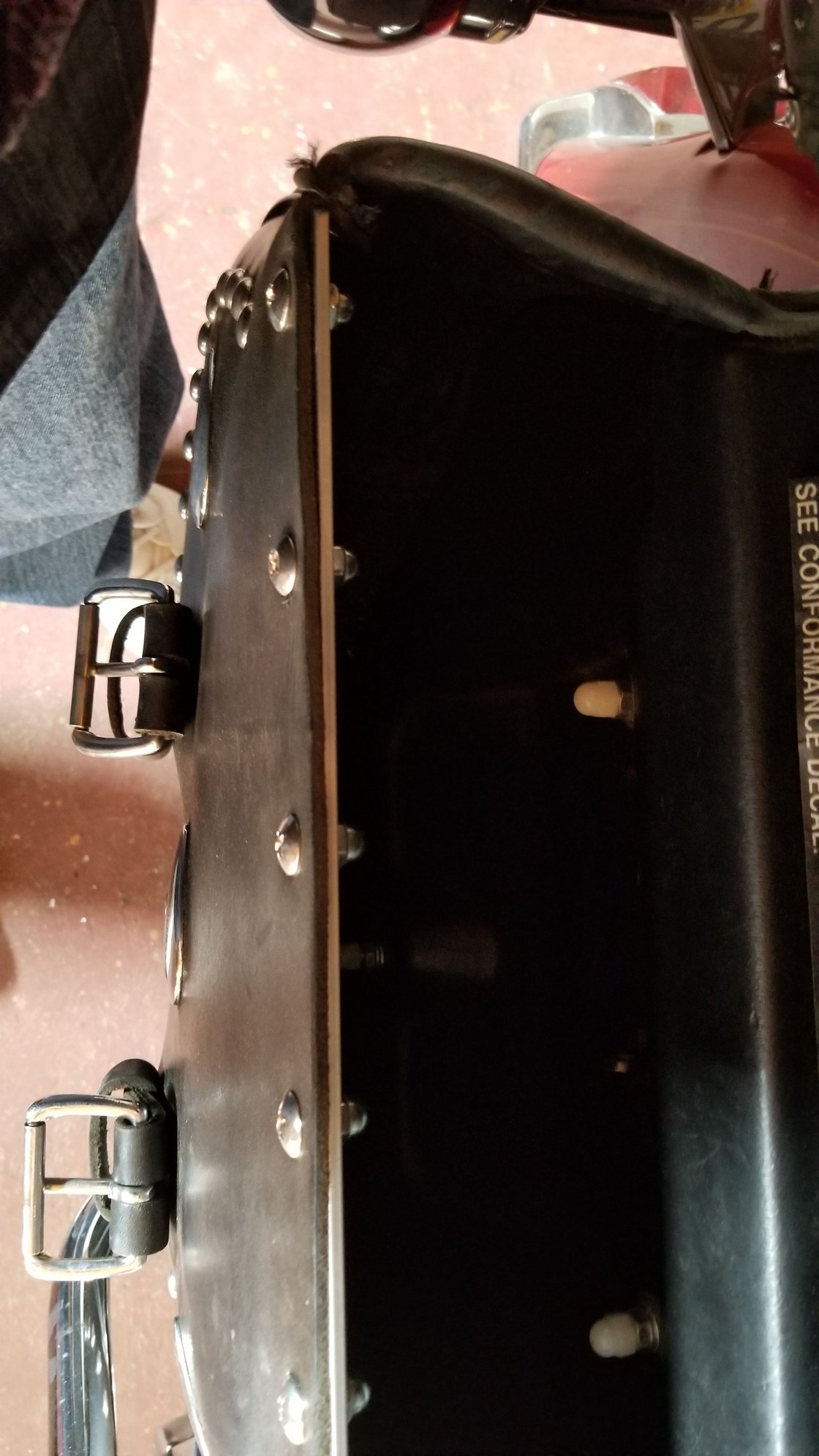

My 1992 Heritage Classic was suffering from the leather saddle bags sagging due to the plastic stiffener in the front edge of the bag breaking. I went to Lowes and got a piece of aluminum and some stainless steel screws and acorn nuts. I drilled and tapped the aluminum bar, screwed in the bolts and capped them with the acorn nuts.

If you put nuts, why did you bother with drilling and tapping the bar?

Overkill
