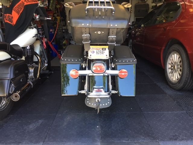

It it would be great to see a picture from the rear of your bike to see how everything lines up
Here you go.

that looks great my stock tail light wouldn't fit either. What year is your bike and model and what's the fairing on the front
The tail light is the stock mount just converted to LED.
I didn't have to modify anything to get the mounts and bags to fit.
2009 Heritage
Reckless Fairing
Leather Pros Lowers
Tour Pak
Progressive 422 RAP Suspension
LED lighting
V&H Big Shot
V&H Fuel Pak
Love Jugs Mighty Mites
