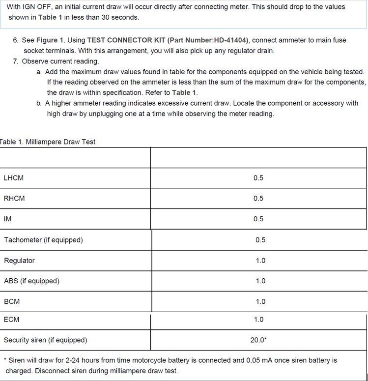

I do have the full set of manuals and was concerned enough to run a few checks such as voltage, charging and more importantly the current discharge test, (parasitic drain) with bike turned off and off the charger, it recorded a very low drain of around 0.02 milliamps.

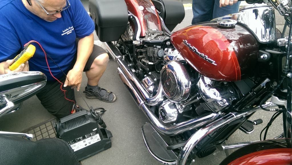

We did not use the bikes for three days, my wife’s Deluxe battery was discharged down to 5.4 volts, nothing, jump started and charging, we took it to the nearest open H-D dealer about sixty miles, they did not have the battery tester it was in Prague but put it on the DigiTech and showed it was charging and the battery volts good.
So we travelled to our overnight stop in Fulda and went to the H-D Dealer there whom stayed open for us and they checked the battery, although it appeared to be OK on the tests, they were not happy with the condition of it and showed us the battery which, as they said did not look like a four month old battery and appeared to have moisture on it near the top so replaced it and were going to put the old battery on the tester the next day, unfortunately we do not know the result of this test as we had to leave in the morning.

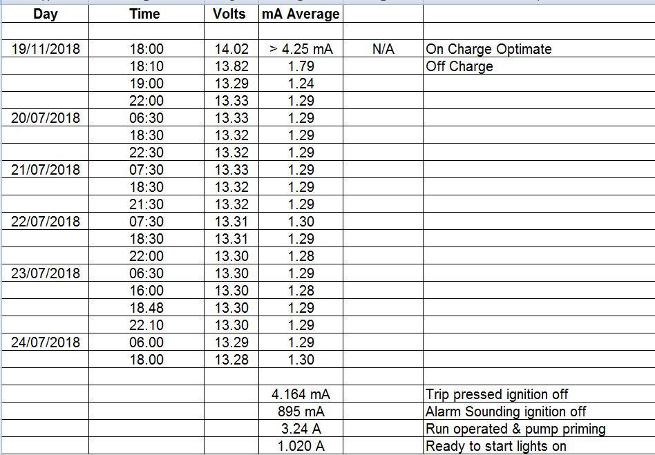

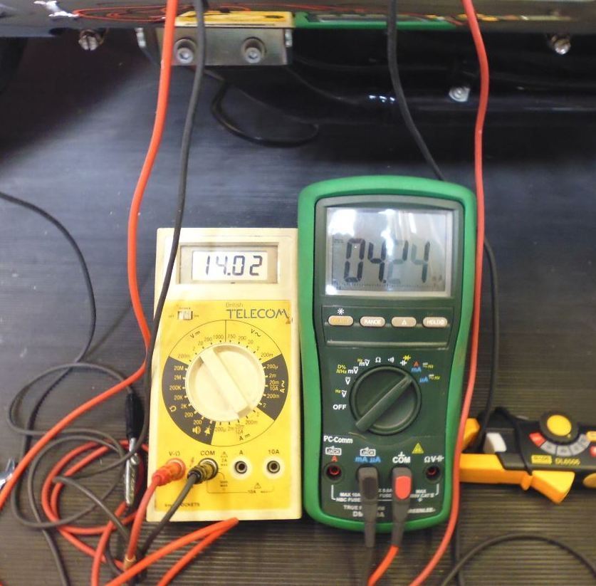

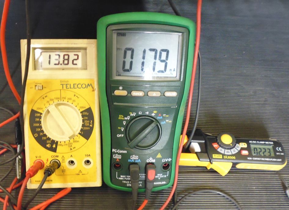

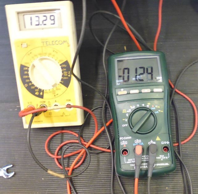

With the negative battery cable removed and the circuit run through an ammeter I logged the reading whilst still on the Optimate.
I then turned off and disconnected the Optimate and let it settle of around ten minutes and took a further reading with the current draw similar to when I tested my Deluxe under 2 milliamps at 13.82 volts
The mini clamp meter is not so acurate but still showed around 2 milli amps
Then a few hours later... with the draw under 1.25 milliamps at that rate it should be no where near remotely discharging a battery in three days!
I shall keep monitoring it off charge for the next few days.

Update
After five days off charge and the current draw and voltage being monitored with an ammeter in series between the negative terminal and cable, being by-passed when not checking the load to ensure no additional discharge was caused by the meter, nothing significant.
The current draw is well below the maximum specified in the manual, averaging at 1.29mA, the reading fluctuates quite a lot and that would be the mean average.
I checked the draw when the ignition was off when pressing the Trip button and then kill switch around 400 mA and drops back after a short while to the 1.29 mA.
With the alarm sounding and ignition off a draw of around 800 mA.
Ignition on, run operated and fuel pump priming 3.24 A, ready to start lights on 1.02A

I'd say your bike is fine and it's not contributing to battery issues. Everything looks normal to me. You've really tested everything you can with the bike in the off condition. Nice job. Are you still experiencing battery issues? How about when you ride the bike for 1-2 hours? Is battery voltage remaining around 12.7 volts? Would say that the charging system is working correctly too.
