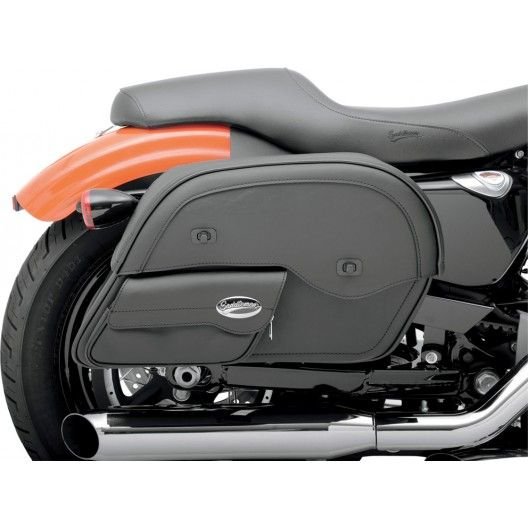

You probably will need to go with some smaller "throw-over" bags.
With the Saddlemen Express you can adjust how low they hang so you should be able to get them high enough to clear the pipes.
I put these on my Wife's Suzuki Savage and "clamped" them on to the U-brackets vs. throwing them over.
I think they look pretty good and are big enough for some rain gear and personal items.
I wouldn't load them down with too much weight though.
https://www.saddlemen.com/express-cr...umbo-universal
