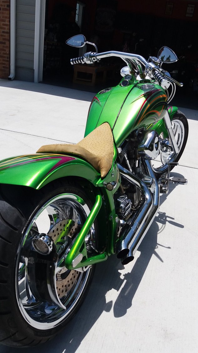

I'll try to get a better picture of the rear section later but here's one so you have an idea.

Really need pics of the other side.
Appears to be an EVO style custom...I would be surprised if there is a Harley part on it.
First you need to see if the swingarm has an offset like the pic below...if it does you probably have a standard width frame...
BUT you almost surely have a primary/trans offset that you will have to remove and get standard parts.
It has no frame horns to you will have to use a strutless fender...which suck for 2-up riding.
And you will have to have a custom seat made if you are going to keep those tanks.
I would ride it as is...or sell it and get what you really want .

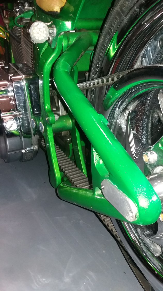

Here's a pic of the other side of the swingarm.

and yeah most of the bike is not original but someone put a lot of money into it. I was going to try to sell it but wanted to have a plan "b", the thing runs great, sounds awesome and could be fun to ride, but that rear wheel is just not me. I also have to change the extended forwards that are on it, i'm 6 ft and can just reach the controls. Anyway I was figuring if I could change the rear section and the tank I would definitely be able to enjoy it more.
I posted a pic of the other side above hopefully that gives you guys a better perspective.
