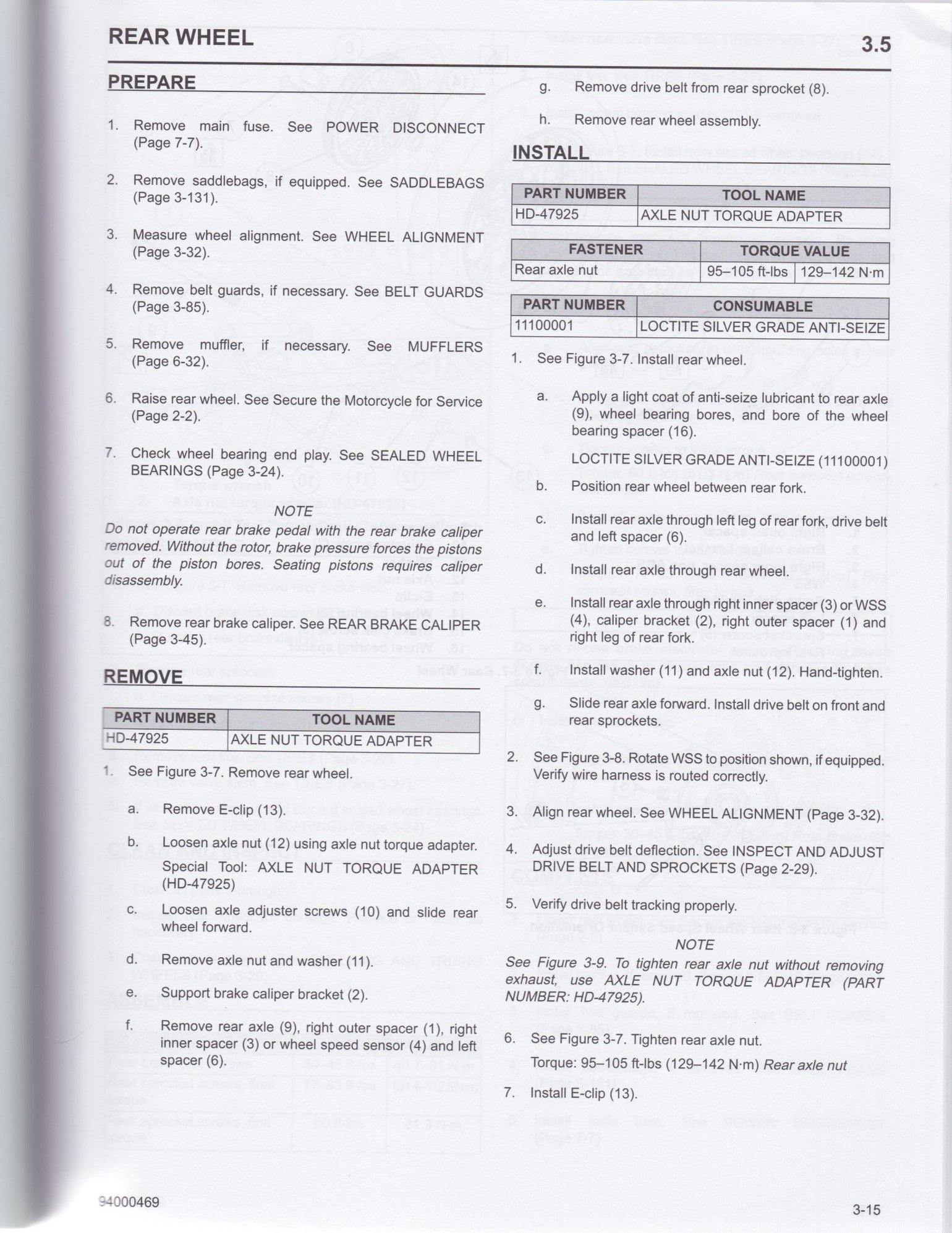

anyone removed rear wheel yet? my fear is spacers and anti-lock brake stuff. any help here?...........nothing on youtube.

It's easy really, I can take it off in about 30 minutes now. Putting it back takes a little longer, because I want to make sure I get it aligned as much as possible, but still not hard at all.
Find a service manual for sure though, it'll save you a lot of google searching, and scolding
I sent you a PM

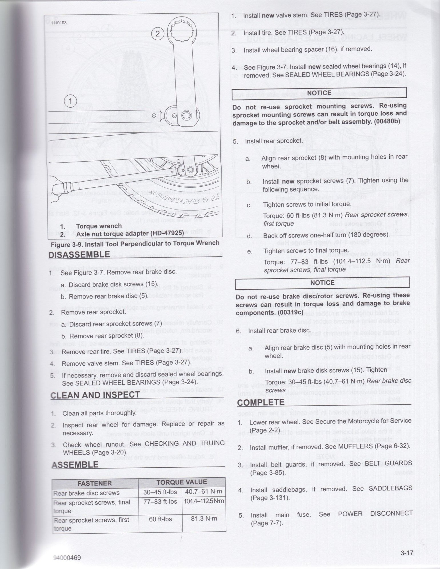

Here the pages from the service manual.
