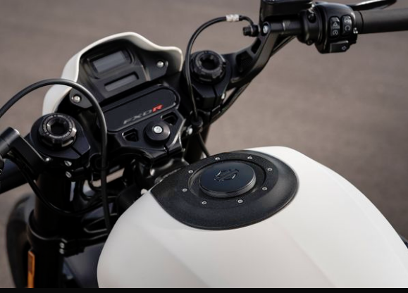

I'm thinking these 2019 FXDR bars for my Fat Bob
The FXDR looks awesome.... if I didn't just buy a Bob I probably would have sprung for one of these
