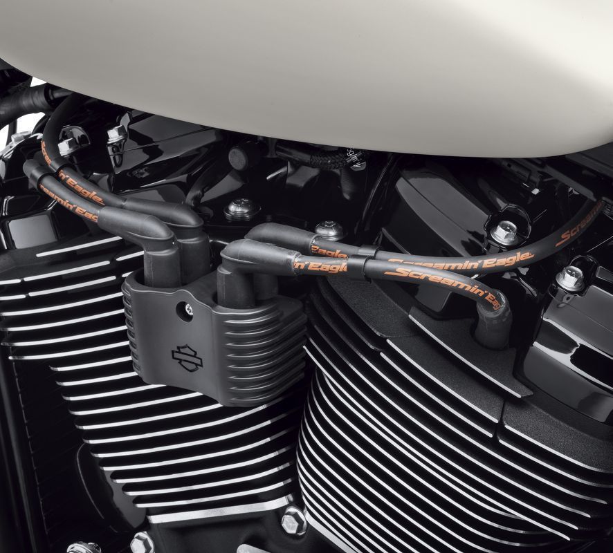

like an idiot I removed my spark plug leads on my breakout 2018 without noting the order they need to go back on
can anyone send me a photo of what lead goes to which plug
many thanks

Can't get at my bike just now, but i did find this image online. If this doesn't help, i can photograph mine tomorrow and post the pics for you.

The two leads at the front of the coil go to the two front cylinder plugs. The two at the back go to the rear cylinder. It doesn't matter which is which on a per cylinder basis as they both fire at the same time - but the leads will only fit one way as the shorter one won't reach the plug on the far side anyway.
The shorter of the two goes to the nearer spark plug.
Then the longer one to the further plug.
If you've mixed up all the wires, just use the ones that are the best length for each plug. It really doesn't matter which one as long as they fit and the plugs in the front cylinder are fed from the front of the coil - and vice versa for the rear.

Thanks guys for the photo and the advice, it was as I expected so all back together now, just didn’t want to mess anything up
again thanks
