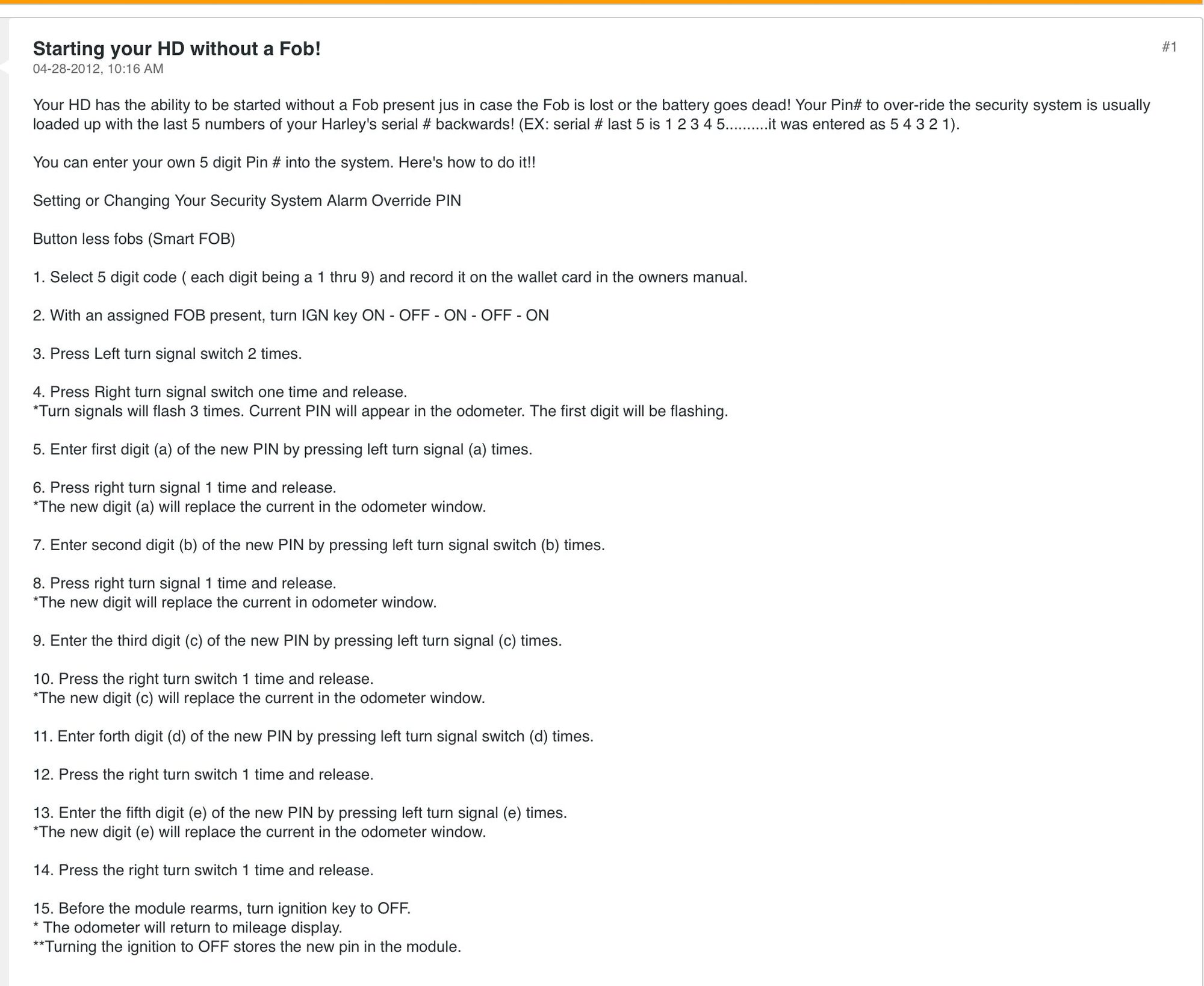

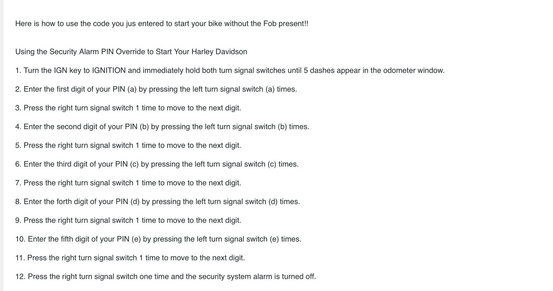

Key fob bypass. There is a code you can manually setup and enter to start your bike if your key Fob battery shouldn’t die.

Not sure how to post links so here are a couple pics
