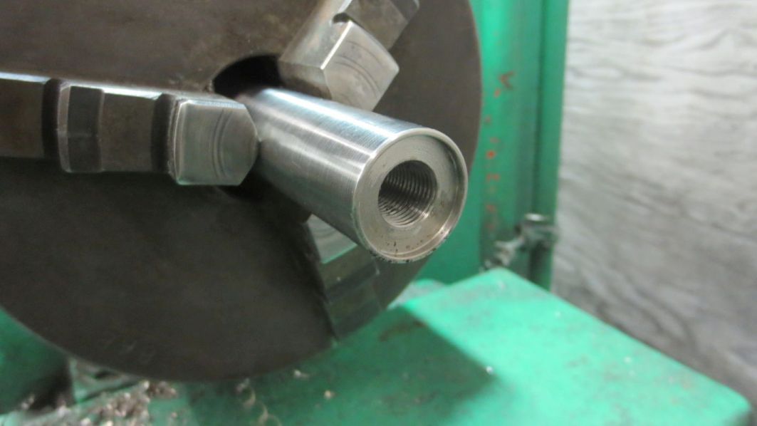

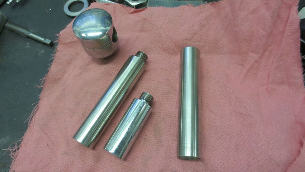

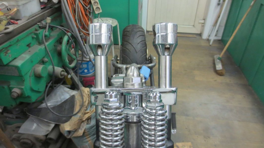

Just made some new risers myself in stainless steel for my springer project.
Hey MoneyFor love the risers too bad I don't have machine shop. But if I did I would do the same. I'm gonna try stock risers helicoiled with studs & acorn nuts instead of bolts. Hopefully keep more clamping force.
