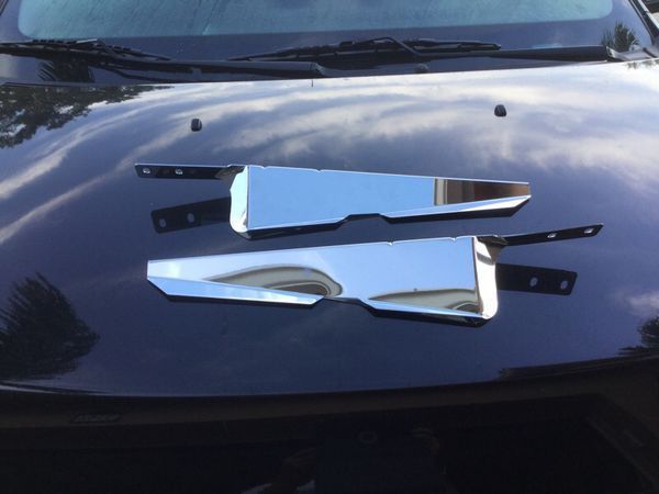

This is what mine look like, I feel like it finishes the lines under the windshield, as for the buffeting, these wind deflectors fix it 100% but at the same time you will lose some engine cooling too.
