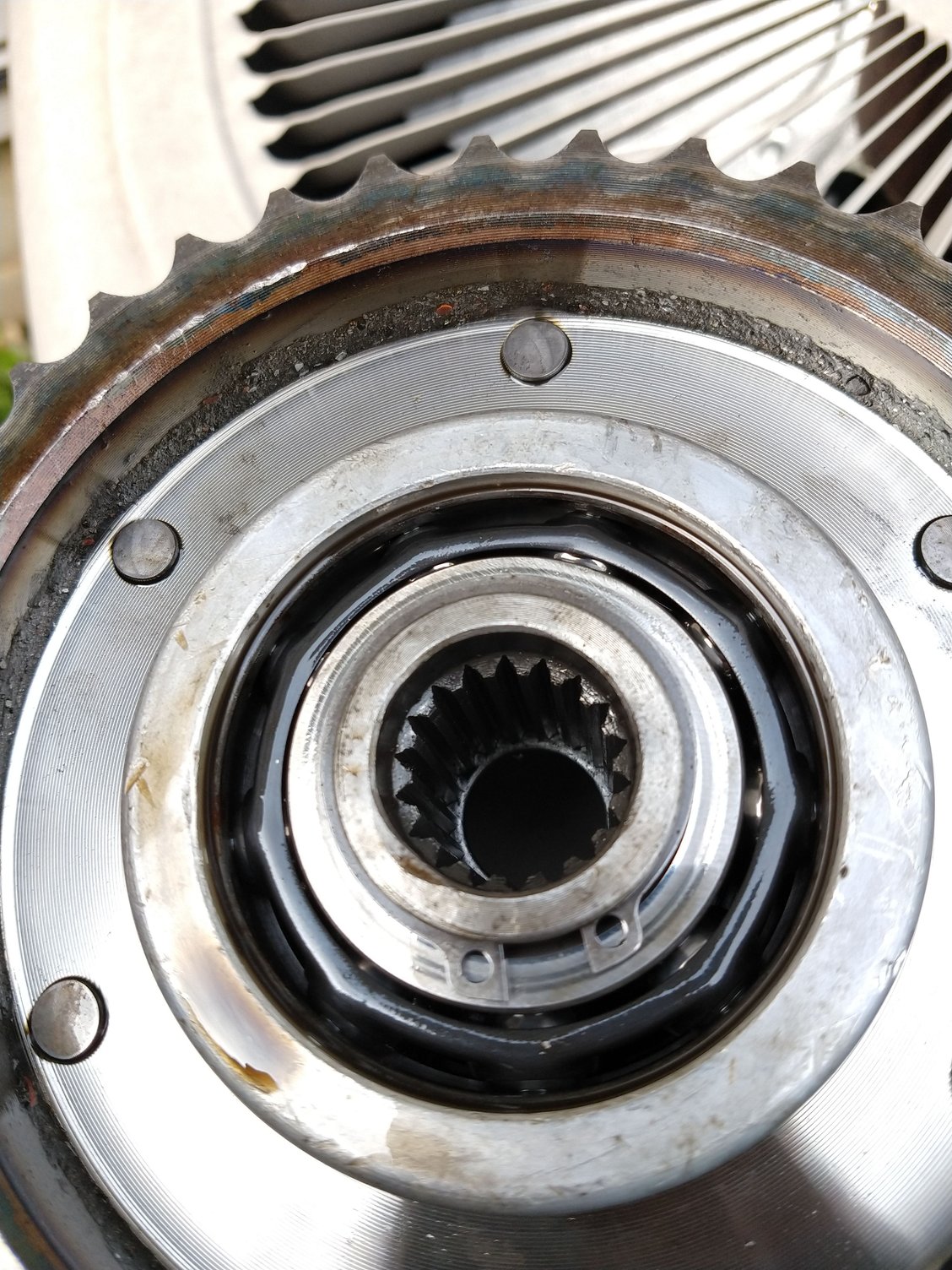

how much play should the back bearing have? The clutch plates also have play is that normal ?

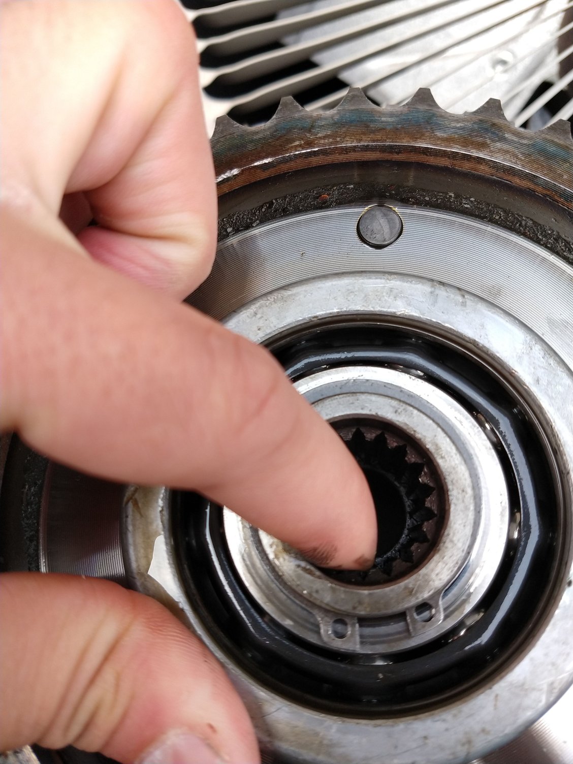

The clutch basket bearing in the back with the splines in the center now is the whole peace supposed to spin or just the bearing because it dont... Yes alot of it does help I tried finding a manual online... Don't have alot of money to spend on a $70 manual right now lol.. thank you when you hold the basket assembly put your fingers on the front center plate that is what has play in it. Like I said the bearing don't really want to move. The bearing on the primary trans shaft has no play ether just wondering about the noise.. may replace it while im there.

The clutch hub bearing is pressed into the clutch hub... so if I understand you correctly, just the bearing is supposed to move...
When you say bearing on the primary trans shaft, are you talking about a bearing in the trans case, or the bearing in the primary chaincase that the trans shaft comes through.....?
If you replace the bearing in the chaincase, there is a procedure where you must re-align the engine/trans/primary chaincase with each other....
The bearing I'm talking about on the transmission I'm talking about is the one on the primary case. The one on the clutch I wasn't sure if that was pressed in since it has a snap ring on it.

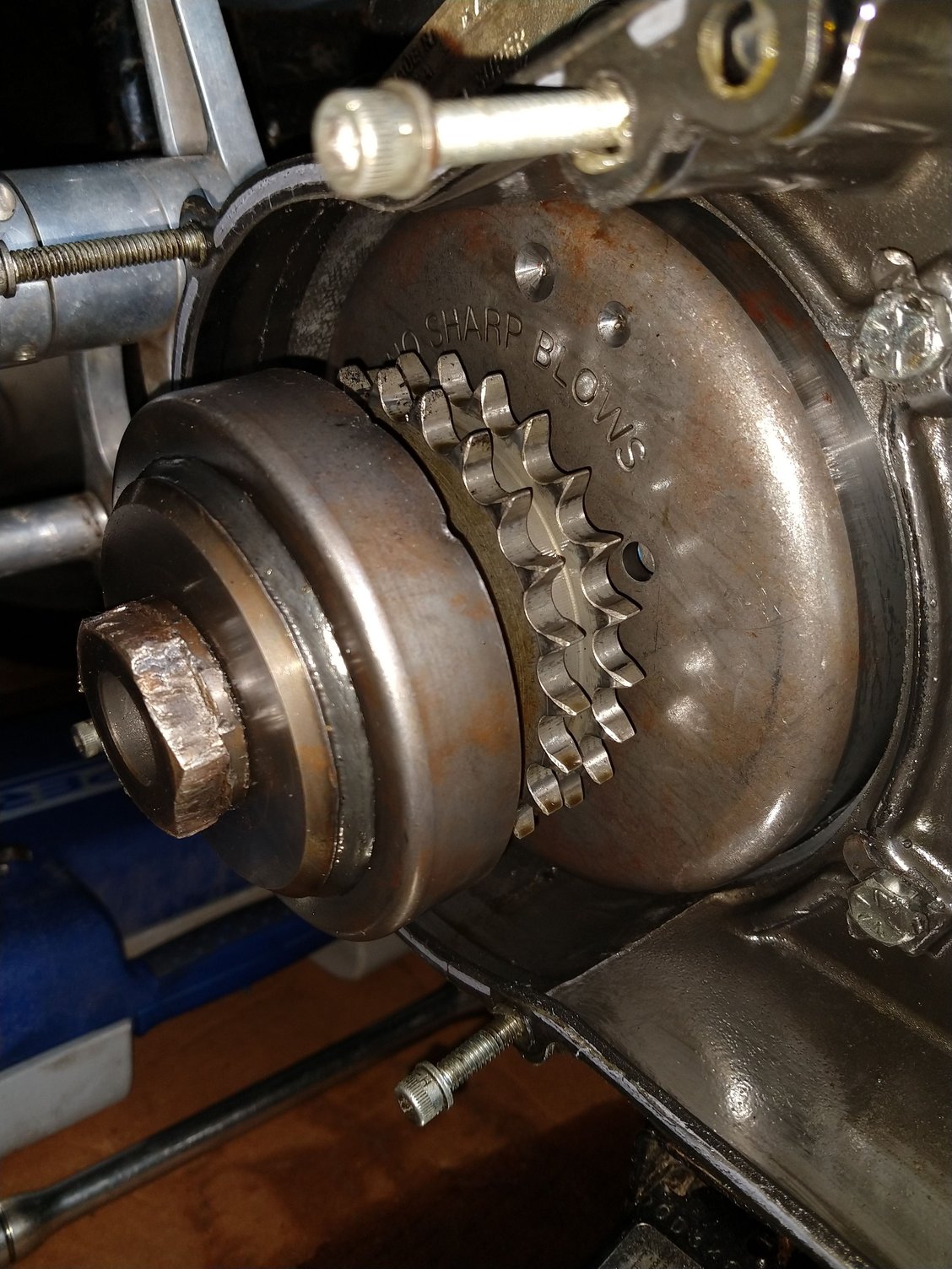

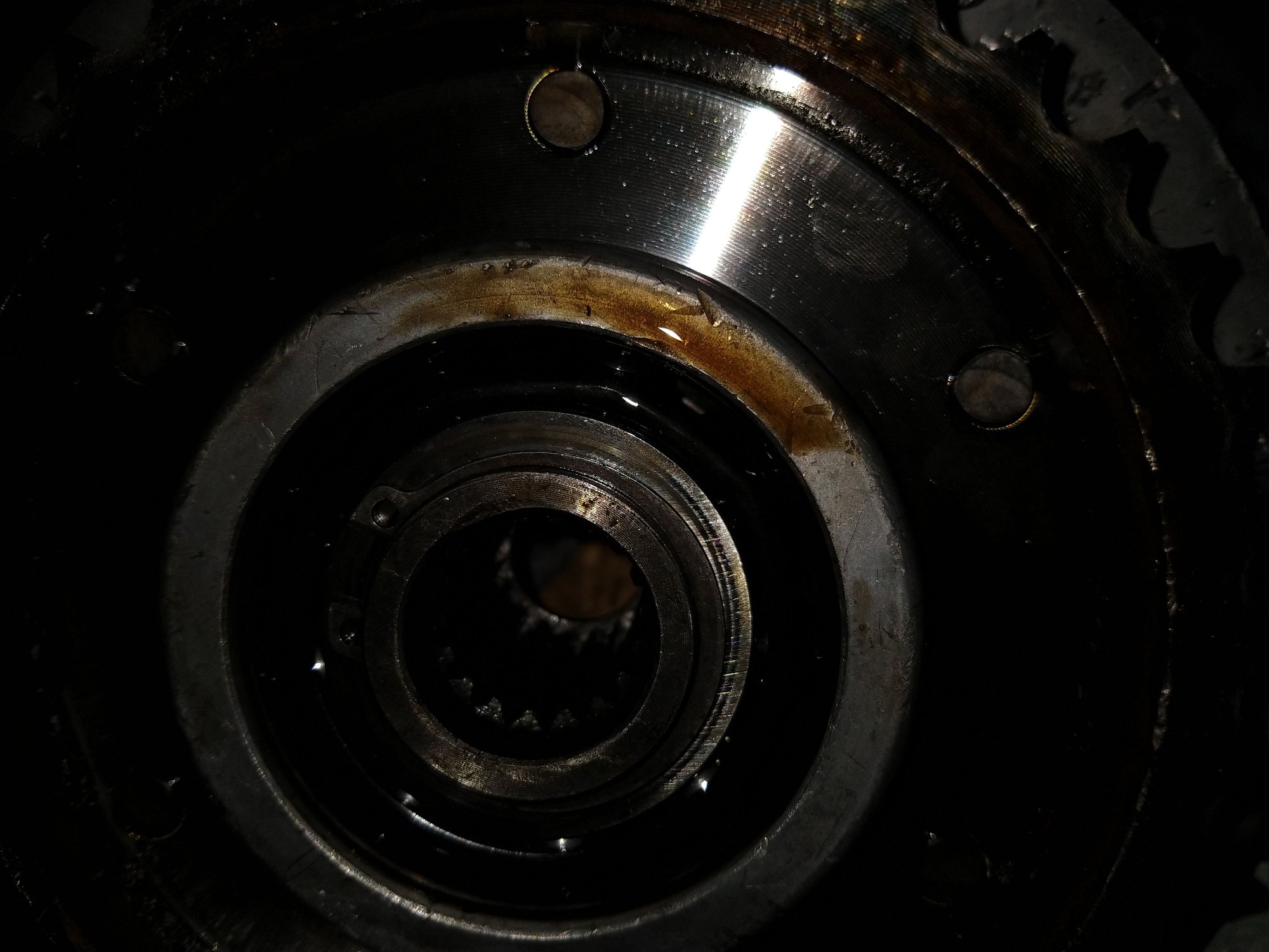

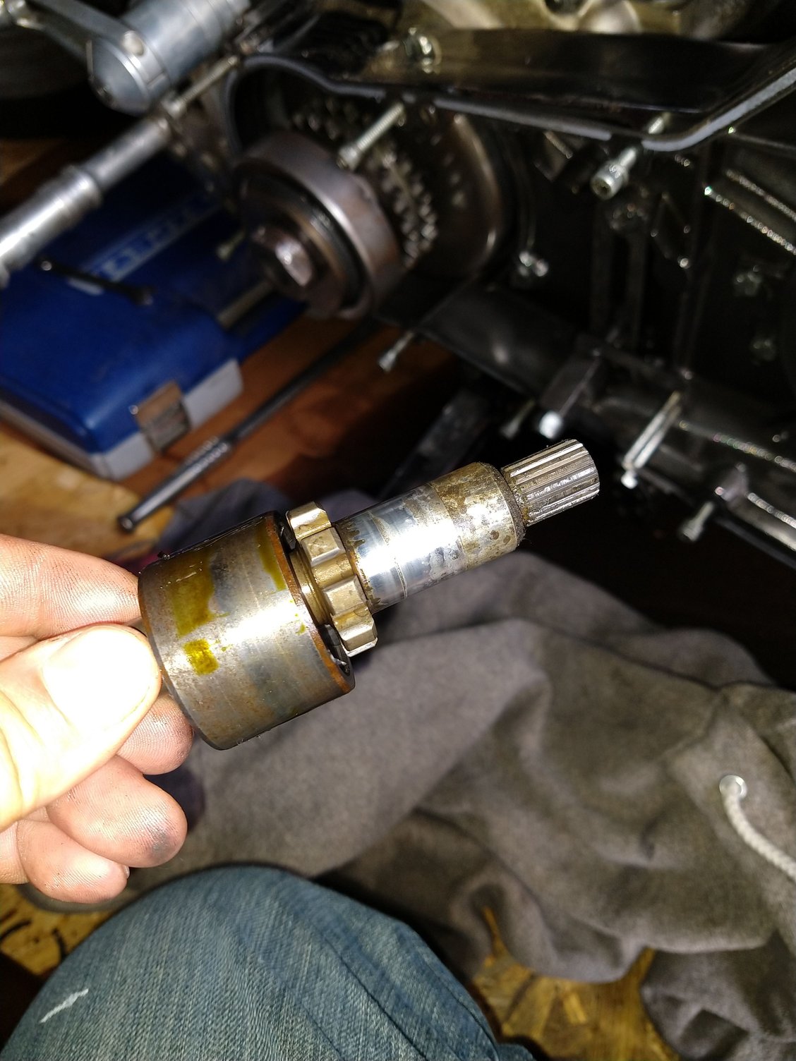

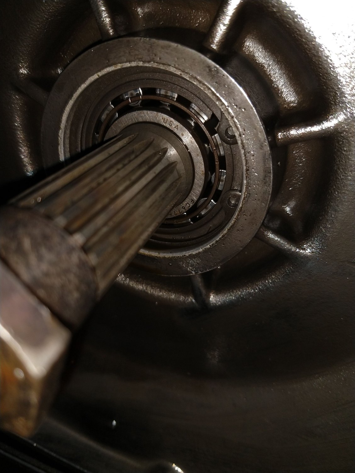

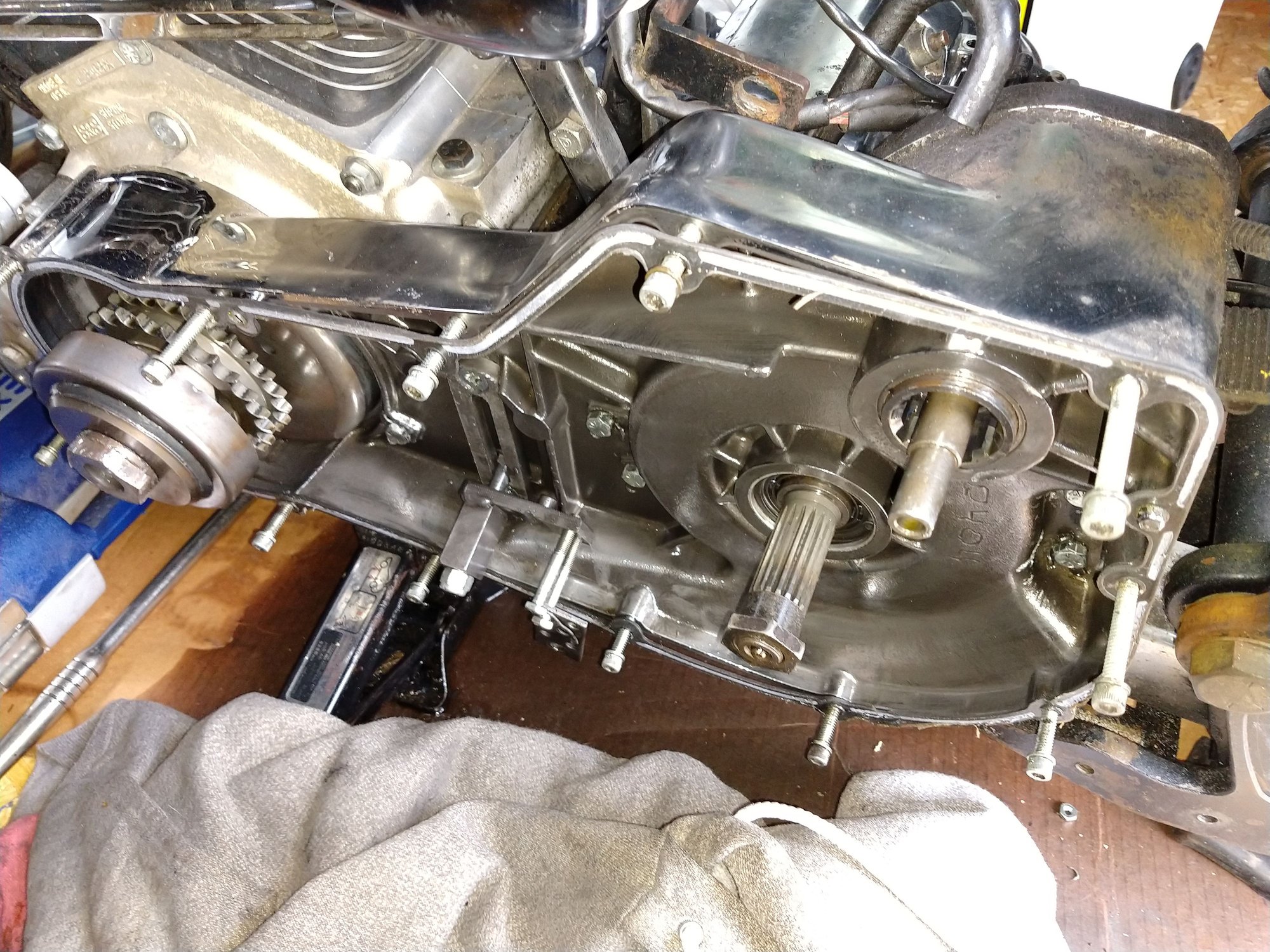

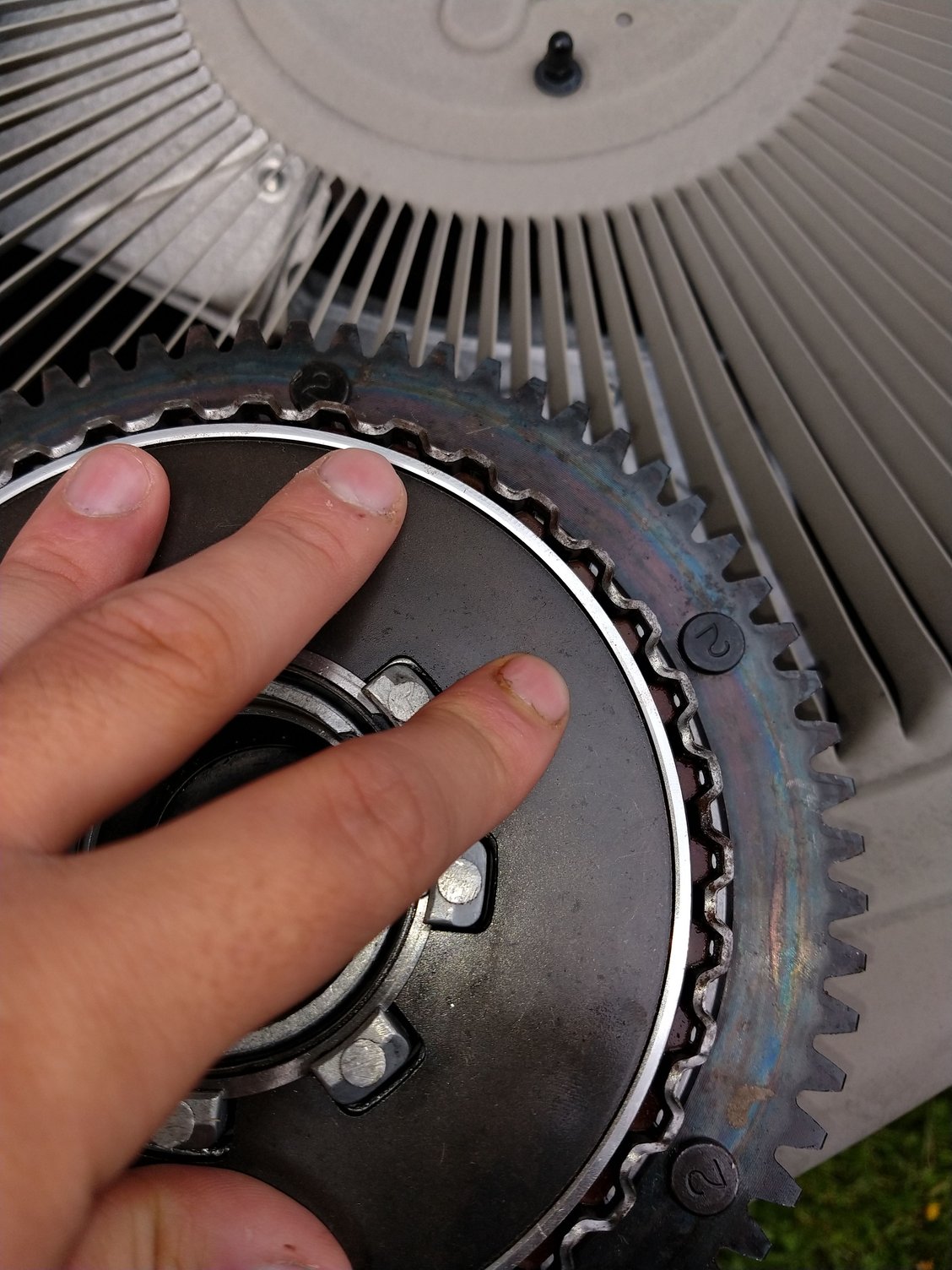

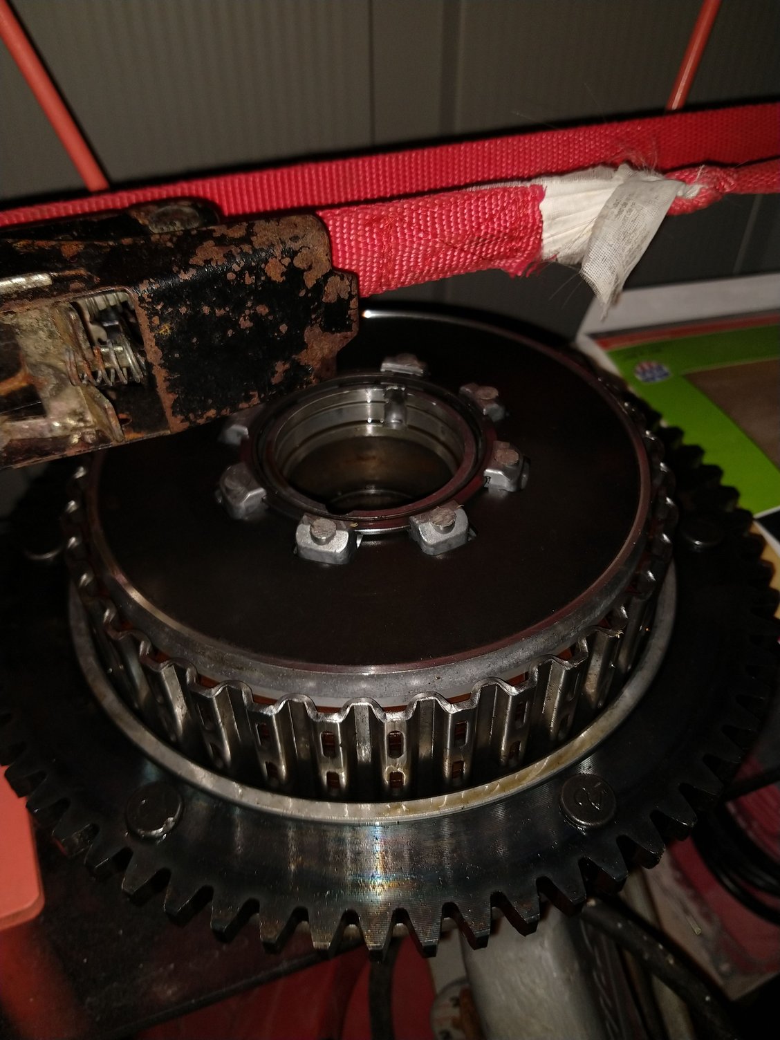

just some more pictures of things to get a feel for what I'm working with.

I didn't pay any attention to the year on your bike. I was thinking TC when I talked about the inner bearing having a race.
How bad is the starter drive gear chewed up? The teeth on that rig gear show some fair damage. That could easily be where the chips you found came from.
Yes it's a split transmission from what I understand that the split trans doesn't have the bearing race on the primary shaft. The started gear doesn't seem to be to bad but like I've stated I'm no Harley tech by no means. I thank that could be from part of the metal in the bottom along with the ring gear as well..
