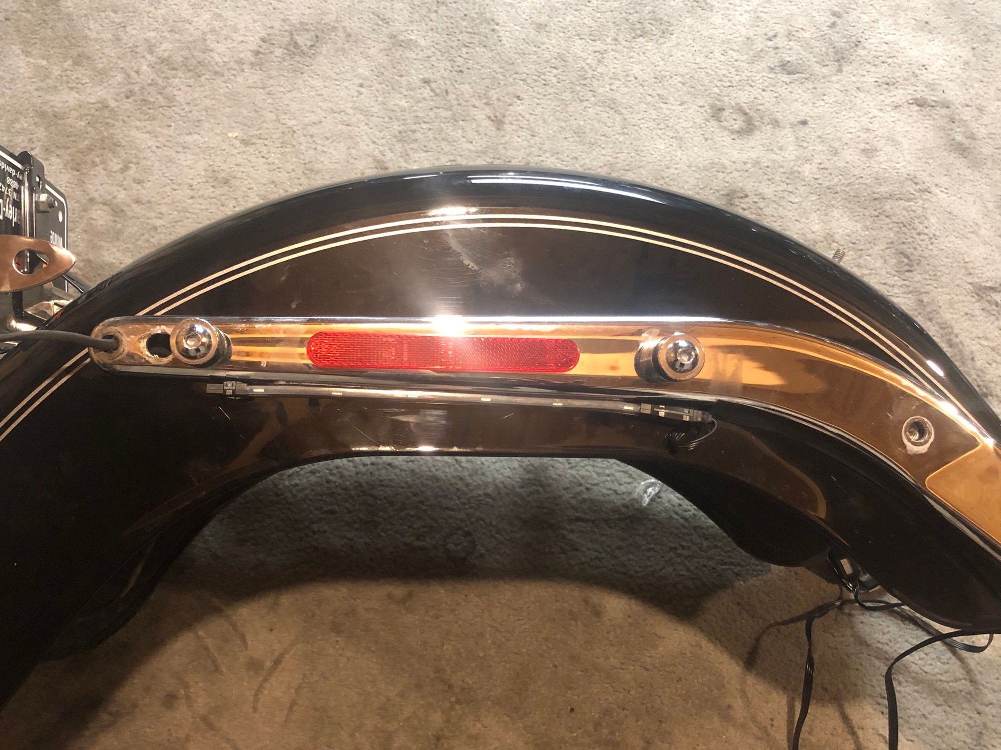

Old May 25, 2019 | 07:20 PM
Pylot7's Avatar
Pylot7
Joined: Aug 2017
Posts: 126
Likes: 27
From: Black Hills of South Dakota
Front View
