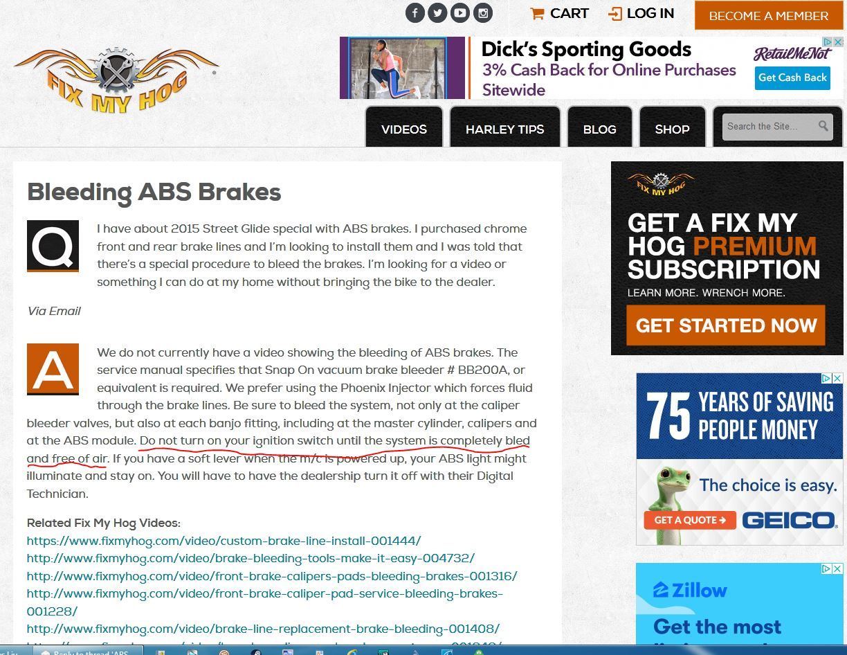

From: Canada

I have done this dozens of times with ABS systems, no problem at all just like donhoe said do not turn on the ignition and everything will be fine. You do not want
to seek any problems and just stay off the ignition switch. I just use a regular bleeder powered by a compressor.
