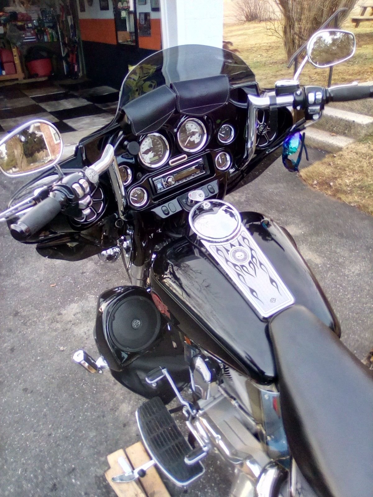

my 10" Yaffee hooks...Easy enough, a caveman can do it!
