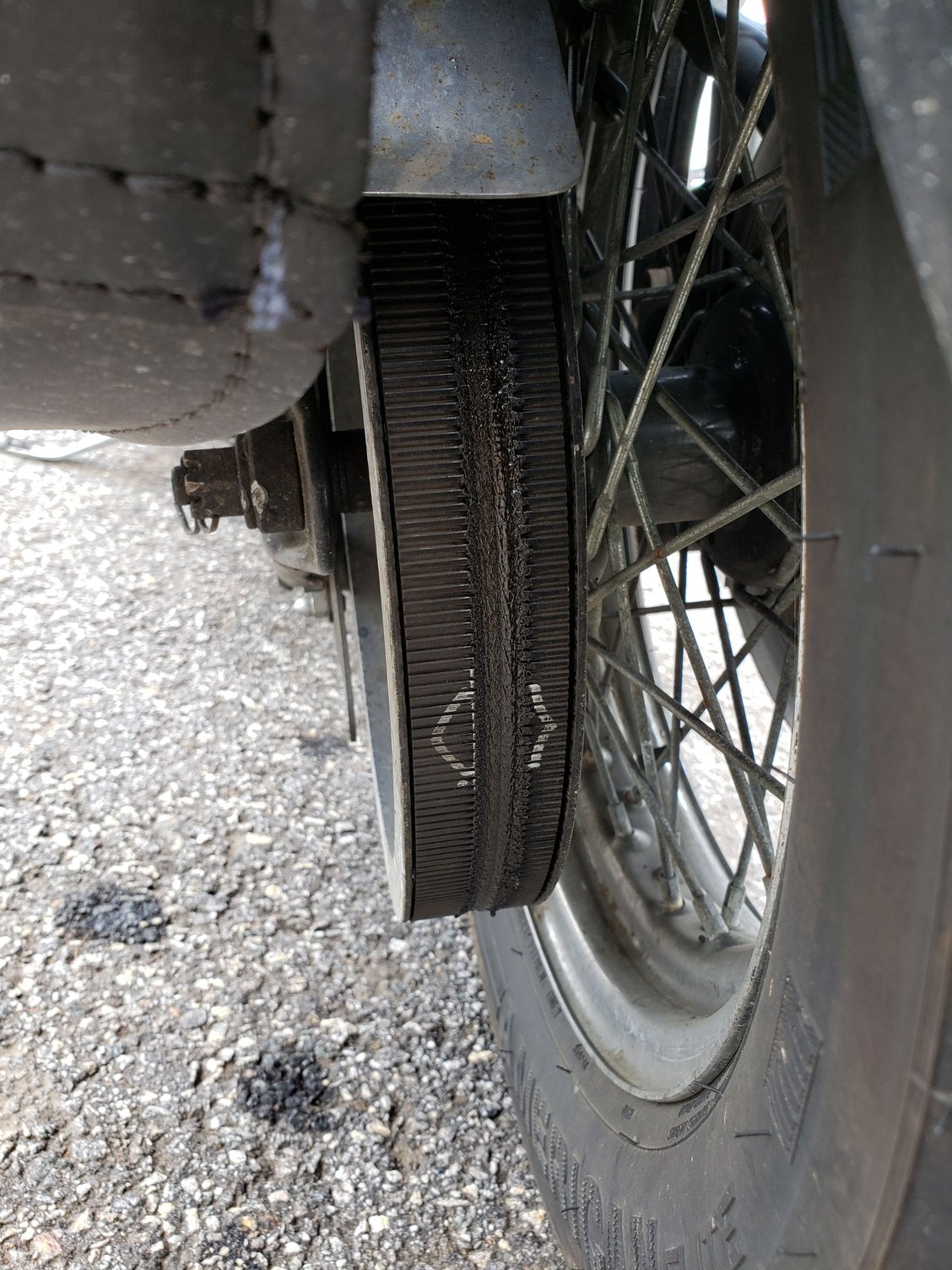

Well found this today not very deep but cant find what rubbing. I rode bike for about 45 min at food speed felt belt and not hot from getting rubbed on. Question should i replace now or.can i wait till winter and how hard is it to replace.

In my humble opinion, that belt has had it! I would not ride the bike until it is replaced. A factory service manual will help guide you through the process, here is a write-up and video showing what is entailed as well
https://www.hdforums.com/how-tos/a/h...ve-belt-414181
Of course, find the cause of the damage before replacing the belt.

That belt is toast. Replace it.

You got a stone caught between the trans/primary case and the front pulley. Doesn't happen often, but I've seen it before. I wouldn't run that belt if it happened to me.
I agree on both points.....
While changing the belt is time consuming and kind of a pain.... it's easier to do it at the time of your choosing, rather than stranded along the side of the road, in the middle of nowhere....
