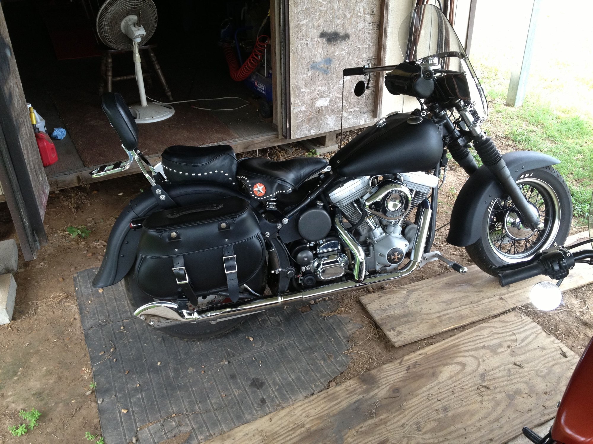

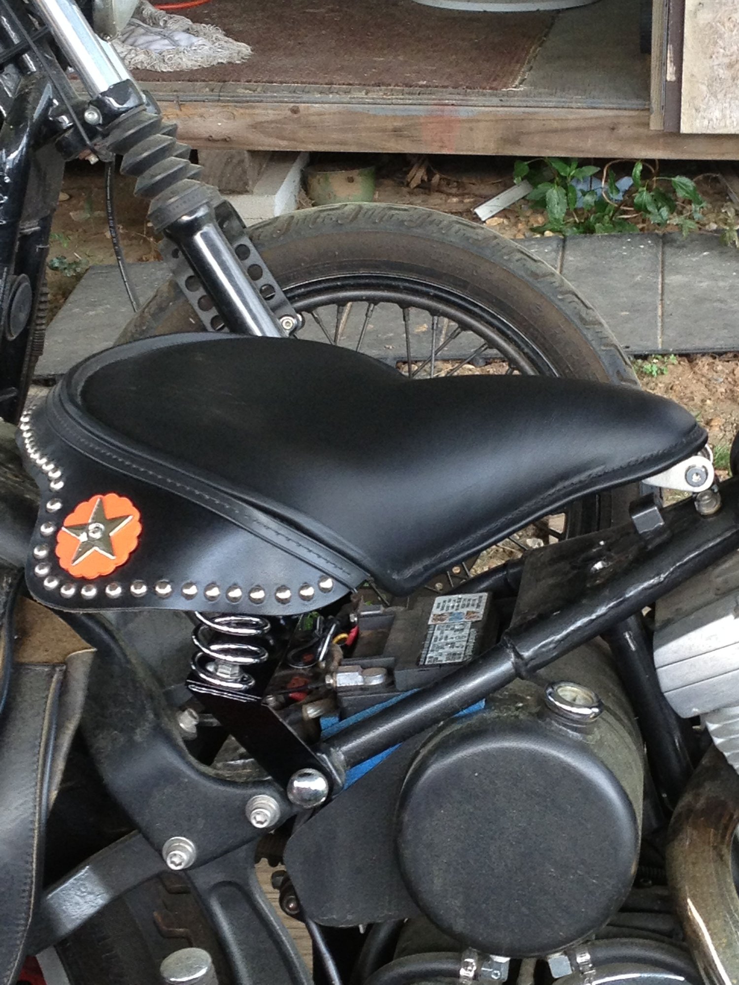

Not exactly sure how basically going back to a stock Sloptail suspension set-up is doing anything to make a RG out of a Heritage - completely different frames, engine/tranny/swing arm mounting, and so on. I can see the advantages of getting the bike back to standard suspension, front wheel/tire, but would go to better rear shocks, some emulators in the front forks, and even an old-style police solo seat on springs or even air bags. That seat even makes my '87 Sloptail ride like a dream.
Cop solo on springs with a scrounged passenger portion of an old stock Heritage seat.
Close-up of the cop solo & springs & spring perch.
