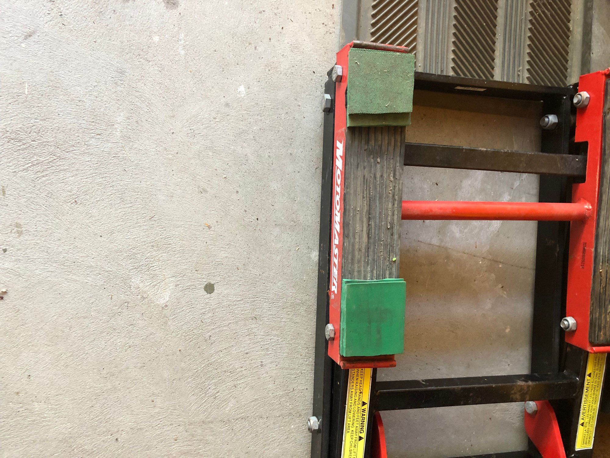

When I had my heritage, I put thick rubber spacers on the jack. Just the front and rear part where the actual frame tube hits.
This allowed me to put the jack where I needed to raise the bike so it was balanced. No pressure on the shocks. Don’t want to put weight on those. I had the exact same lift.
Good luck.

so basically you r saying positioning under shock is ok ,but with additional rubber which will protect the shocks and take load onto the jack risers .Do you have by any chance pic of your modified lift ? Tx

just a mock up of what I had. If you want to lift bike balanced,you have to lift underneath shocks.
Don’t need much to give you clearance from the shock.

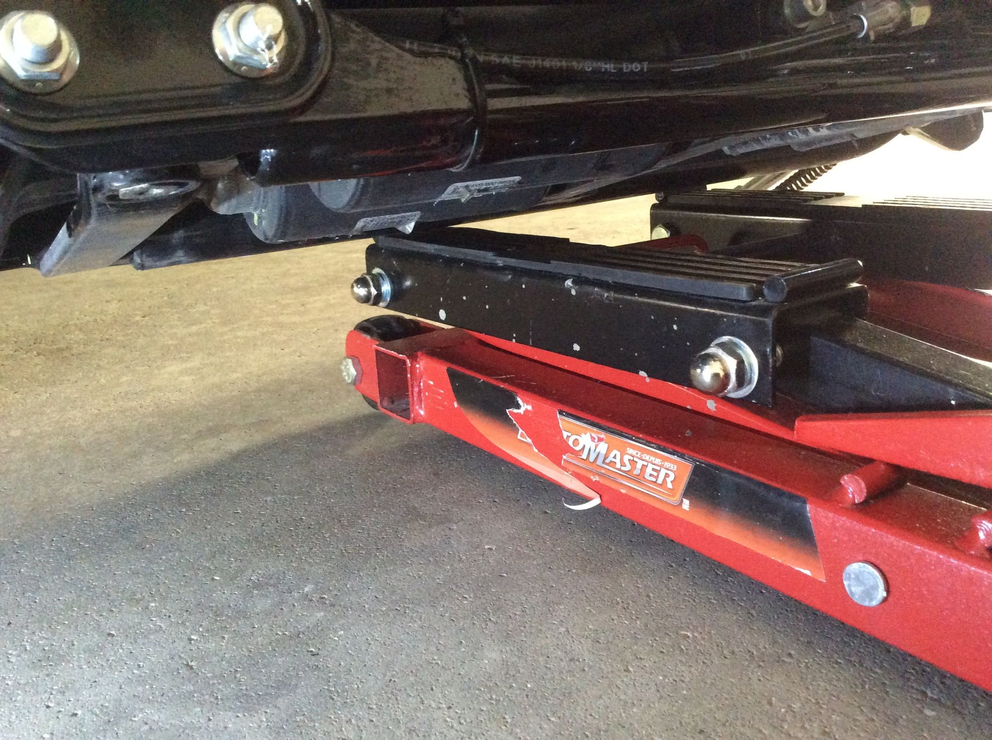

That`s what I did with my bike too. It`s the `05 Fatboy CVO in my sig pic.

I use the frame protectors (https://www.harley-davidson.com/store/frame-protectors) on either side of the shocks and align the front bar of the jack with the center of the engine (under the timing cover).

Looks like a good system, but are the frame protectors only used on the rear jack rail ? I don’t see them on front jack rail in this pic.
