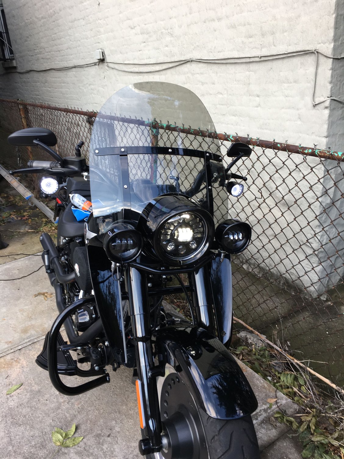

Old Aug 17, 2019 | 07:01 PM
Fatboy16S's Avatar
Fatboy16S
Joined: Dec 2016
Posts: 225
Likes: 62
From: East Coast
I have the sunpie led headlight with the HD auxiliary light kit and went with the custom dynamics auxiliary led and turn signal led lights and the HD wind splitter windsheild. Pics show DK H4 led. Got Sunpie a few weeks after pic. Sunpie is 2 years old and absolutely no issues
