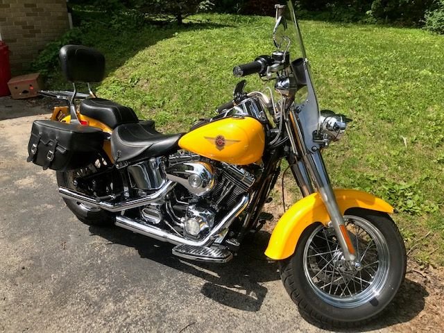

Default 2000 Fat Boy Wheel
I have this nice 2000 Fat Boy. Lots of mods, but still the skinny rear wheel. I believe it is a 16 x 3 with a 130/90-16 tire. I want to put the original disc wheels back on if I can get a bigger rear wheel to fit. Can I use a stock 2000 disc wheel with just a wider tire? The rear wheels got bigger later on. Like, 2003 was a 16 x 3 with a 150/80-16 and 2007 was a 17 x 6 200/55-17. Will a later year disc wheel that accepts a wider tire size be mountable? The website I'm looking at - (sep.yimg.com) - shows a larger custom wheel is mountable, a 18 x 3.5 w/ 150/70-18, but that means I have to buy a 18" wheel, i think, which would be expensive, I suppose, if they even have a solid disc one. I just want to get a bigger cheap OEM rear disc wheel off eBay.
WHat should I look for?

Maybe i can phrase it more simply. Will a 2003 or 2007 rear wheel mount on a 2000 Fat Boy?
