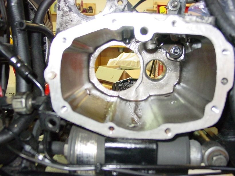

Originally Posted by 95fxstc
Got it off noticed it was weeping a little oil where the transmission bolts to it. Do you know if there is supposed to be small gaskets around the bolt between the chain case and transmission or should I just use a small amount of silicone
The mounting holes in the transmission case do not open into the inside of the case, so no oil is going to leak out through the bolt hole.
Looking through from the right side, you can see there are no bolt holes open into the left (far side) side of the transmission.
