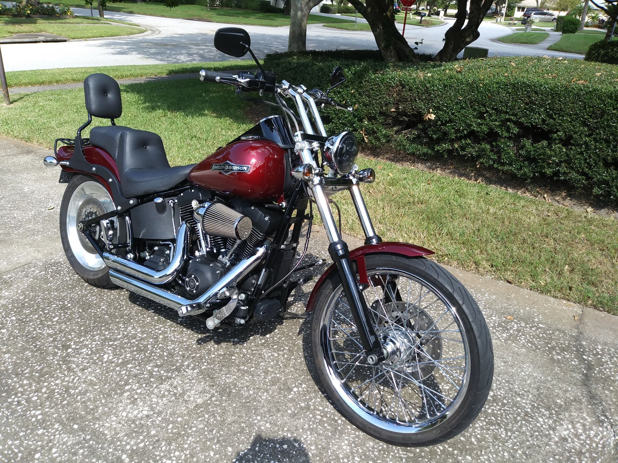

Not sure what risers you are looking at, but for Drag Bars to be comfortable, IMHO, you need them to rise up AND pull back.... That is usually achieved with a set of pullback risers, with the drag bars mounted to the risers....
I recently put drag bars on my '01 Springer from Wild Ones. They were a one-piece set up... both bars and risers . They list as 6" rise with 11" pullback. At 5'8", I find them very comfortable...
They remind a lot of the drag bars on my old 1978 FXS, which I likes a lot. I believe that bike had 4" or 6" risers, and I forget the amount of pullback.
There is a new look going around where the drag bars go straight up, no pull back (or very little), kind of "Ape Hanger" drag bars... I don't like the look, nor do they look comfortable to me.... but to each their own...
Here's a few pics of my Springer drag bar installed...
I agree about the pullback. My Night Train OEM setup was drag bars with 6" straight risers. I kept the bars but changed the risers to 8" pullbacks. Much more comfortable.
