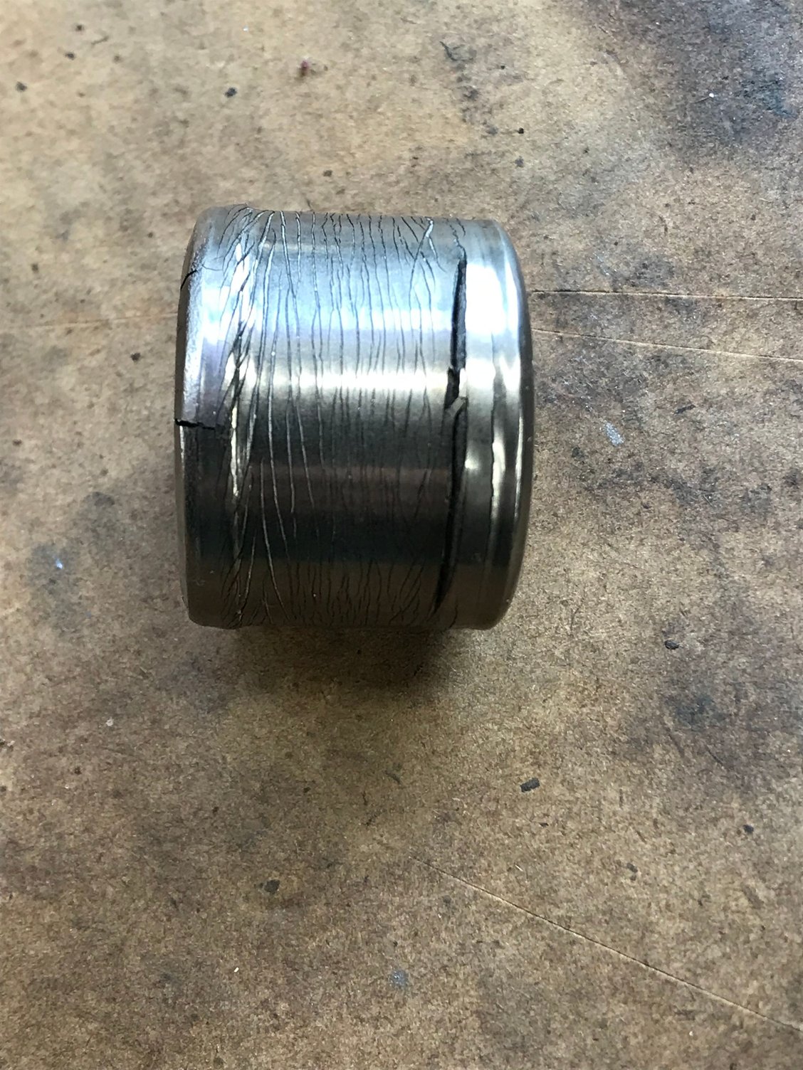

Hey guys just now found this forum, my ride is a 2005 Harley Heritage Softail Springer Classic FLSTSCI. I have been having transmission issues and because of this I found this forum. My main Gear needle bearings keep walking and disintegrating on me and so far I do not know why. I had it rebuilt 5900 miles ago and it did it again, I do not want to go for three. I am thinking of replacing the entire transmission housing and all unless you guys can shed some light in this for me. I have pics if I can figure out how to post on here as a new basic member.

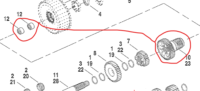

For clarity (mine) Are we talking about these bearings?

If it is the main drive gear needle bearings, it has nothing to do with the transmission case...
The inside diameter of the gear is probably out of spec.
Install a new main drive gear and bearings, or find a complete low mileage gearset.
Are you doing this work yourself?

Yes, but both bearings are inside the #10 as in your picture. There is no keeper ring nor spacer between them it is simply a friction fit.
