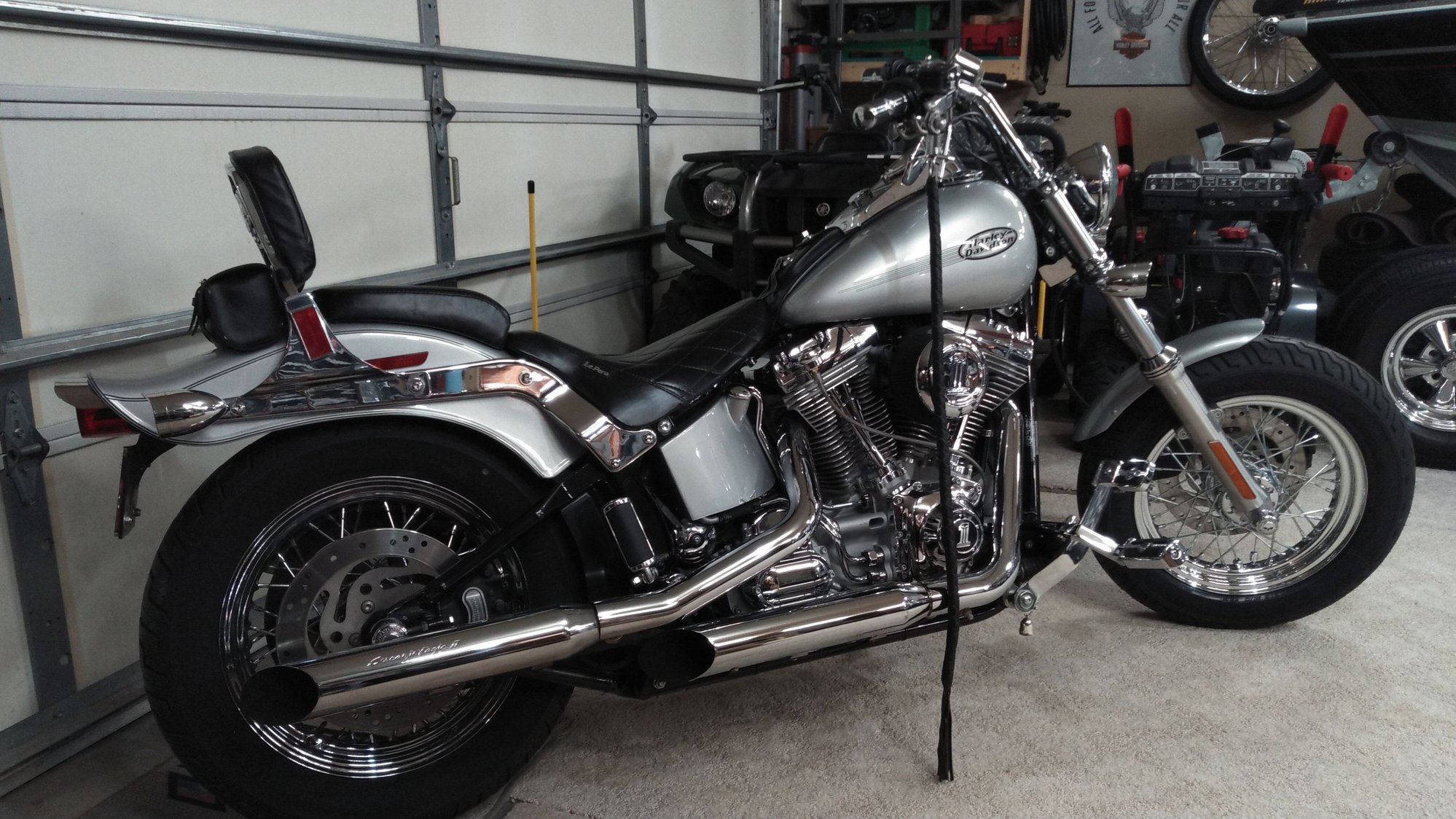

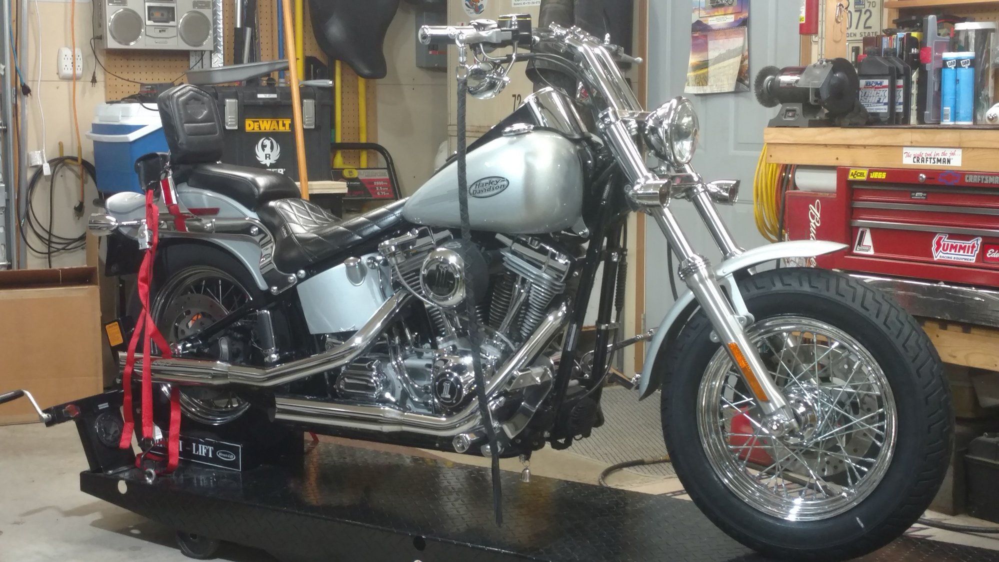

last fall I installed a 16" wheel on my softail standard and ran the bike without a fender for a short time and soon realized I wanted a fender back!!
right away I noticed a fairly loud knock when I would hit any substantial bumps!! figured it was probably due to the fairly light 41mm forks having some flex?
so I put my fender back on and the knock went away but looked ugly because too much gap between tire and fender!! so I ordered a RSD fork brace and found a different fender!!
ended up just using the fork brace for the mount for the new fender, got fender painted and brace installed but haven't had a chance to ride it yet due to still having winter up here in the Dakotas!! come on spring!!
Too much gap with fender
Finished

I really like what you've done with your bike and appreciate you posting up those pictures. Thanks for the feedback on how the bike rode minus a brace it's leading me in the direction of adding one.
