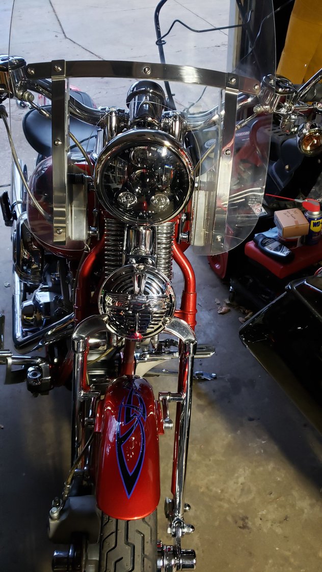

Here's a pic of the horn mounted to the Springer along with the new LED headlight. The light is not really old school, but we have a lot of deer in MI and I wanted maximum brightness....

Nice looking bike, what about using an LED bulb in the old light housing?

The LED bulb is in the factory housing. I just had to use part of the rubber gasket from the old light to keep it from rattling when I put the retainer ring on.
