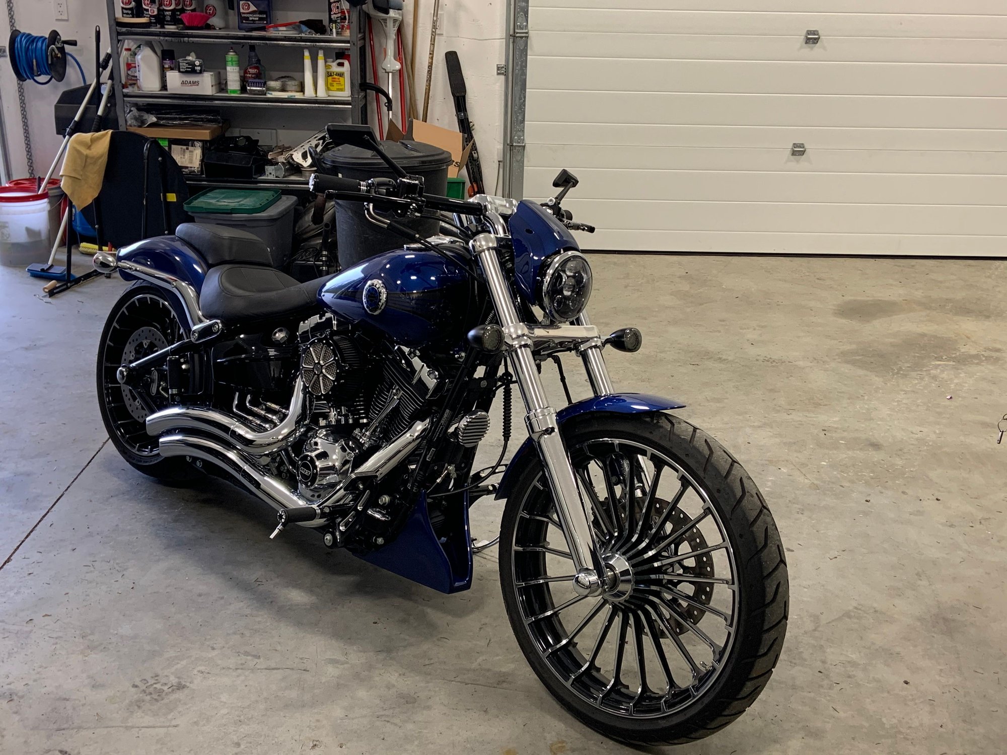

looking for some advice to make this thing a little more comfortable for me to ride , im 5 8 , anyone do a few mods to these bikes to make them a little more comfortable to ride? I heard a slightly higher riser and seat
can make a world of difference? any information would be awsome ! also what kits are out there to clean up the back tail lights ? id like something a little more streamline looking ! Pic for Attention

On my Breakout I installed 2014 CVO Breakout handle bars on and I'm happy with ride 5'11' .This also helped with rear view mirrors.

This pic is not a pic of the risers I made to bring the bars up and back. Its a simple fix. The factory riser base is 1.700 so I just turned a stainless bar to 1.700 and cut them off an 1.750" drilled a 1/2" hole in the center for the bolt. You can see them in this pic.

I'm 5'8" as well and find mine extremely comfortable to ride for a muscle cruiser. I bought mine used and it came with 7" riser bars already installed on it, which probably makes a big difference over the factory drag bars, but I have not ridden a stock one to compare.
