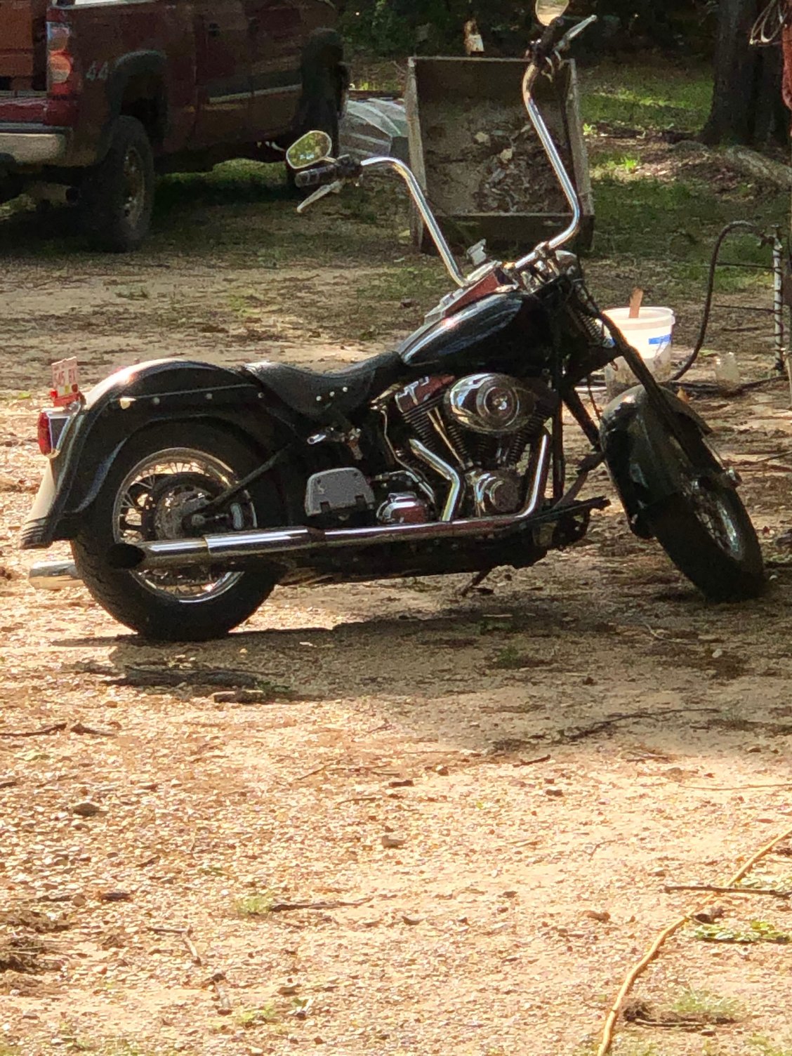

Okay so I put a new stator in since the other one was fried. New VR and I’m still not charging. Had battery tested it’s good. Both stator and VR are cycle electric. I did have a problem with the pins connecting and snapping into the old connector. I’m going to do a test on both stator and VR tomorrow but wondering if anyone else might have a suggestion on what I should check besides this.
