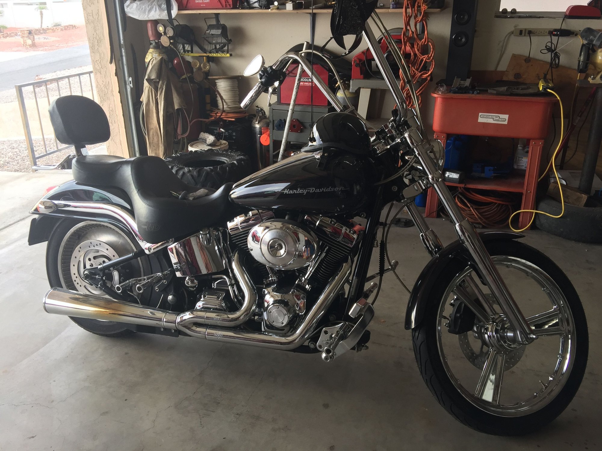

Exclamation IAC cycling
2001 Deuce (FXSTDI)
nothing fancy as far as mods. stock engine. V&H Pro pipe, air cleaner and Techlusion piggyback programmer
recently developed an electrical problem: IAC continues to cycle every 10 seconds or so after bike shut off. does not matter if shut off with on/off switch on right hand control, or main power switch on dash. replaced IAC with spare one. no change. checked both system and starter relays and sockets. swapped starter and system relay. no change. tested all 4 wires from IAC back to ecm. no broken wires. no dead shorts. can see cycling voltage at same interval in plug with digital multi-meter. only way to stop the cycling is to let battery die completely, or pull ecm fuse.
my thoughts are that there is a short in the ecm. does anyone know how to test for that?
does anyone have any other ideas?
does anyone have a known good ecm that they would be willing to loan me for diagnostic purposes?
