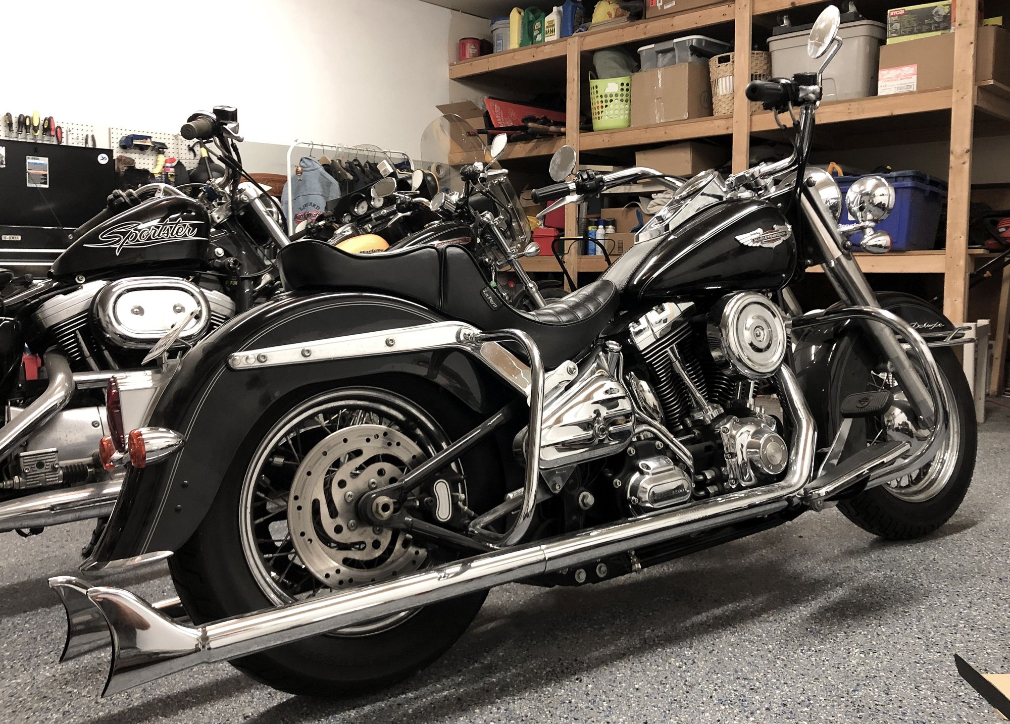

Any pictures of it finished? I'm about to do this in about 2 weeks

Still making final adjustments on handlebar positioning but you get the idea!
2010 FLSTN as of July 2020
