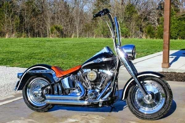

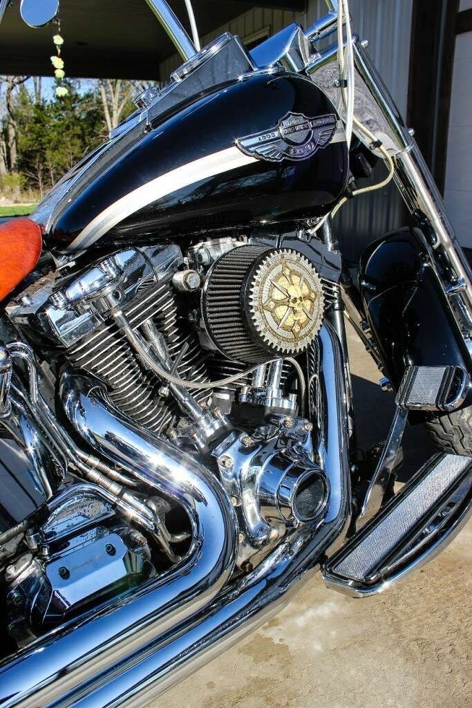

Hey guys, I've done several searches and found several good threads, but what are the first things I should consider looking for on this new to me 03 FLSTF. This is the carburetor version and the carb has been changed to a Mikuni HSR. This bike has had some motor work done by Dyno Mike in Belton, MO. Previous owner is locating all that paperwork for me for the details. I know that cam chain tensioners is the obvious first check, what is the best course of action for a guy on a budget? which cam plate do I switch to? My thing is, if I switch plates or even pull the plate, gotta pull the cams, which means replace the pushrods with quickies or pull the rockers. Can get into a lot of money right off the bat. Do I just check the shoes and run 'em? Does the rear tensioner shoe get worn as bad as the front one? Can I get by with not checking the rear one? If I do have to pull the cam plate, what is the most economical replacement? Thanks in advance for the advice!
