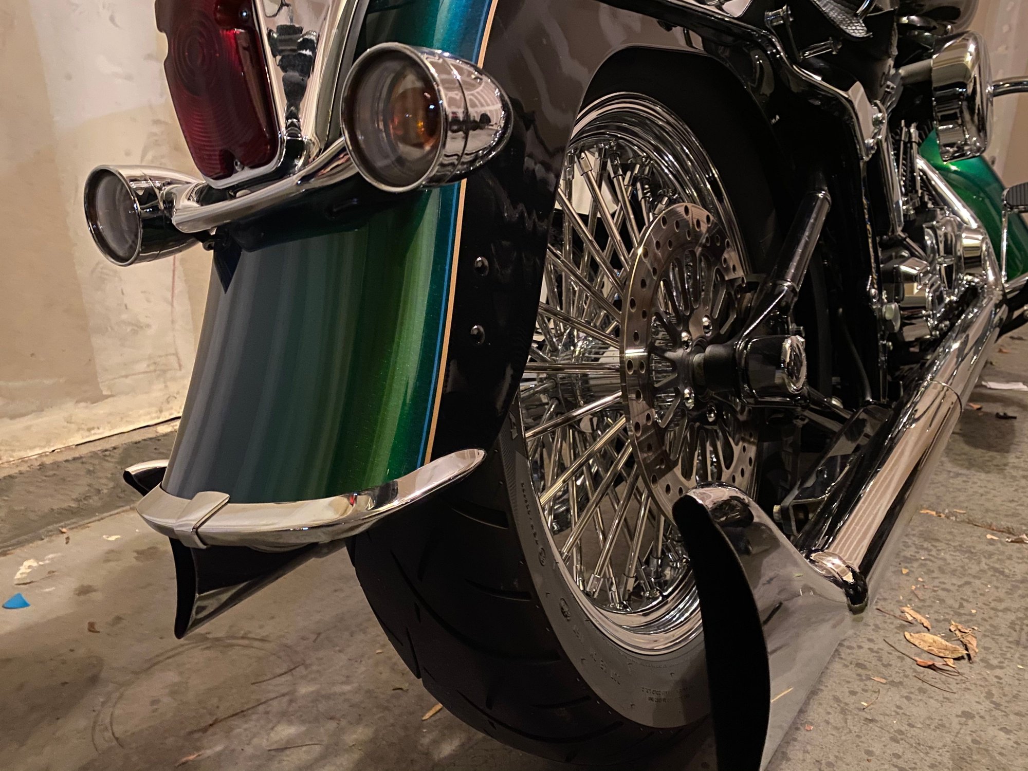

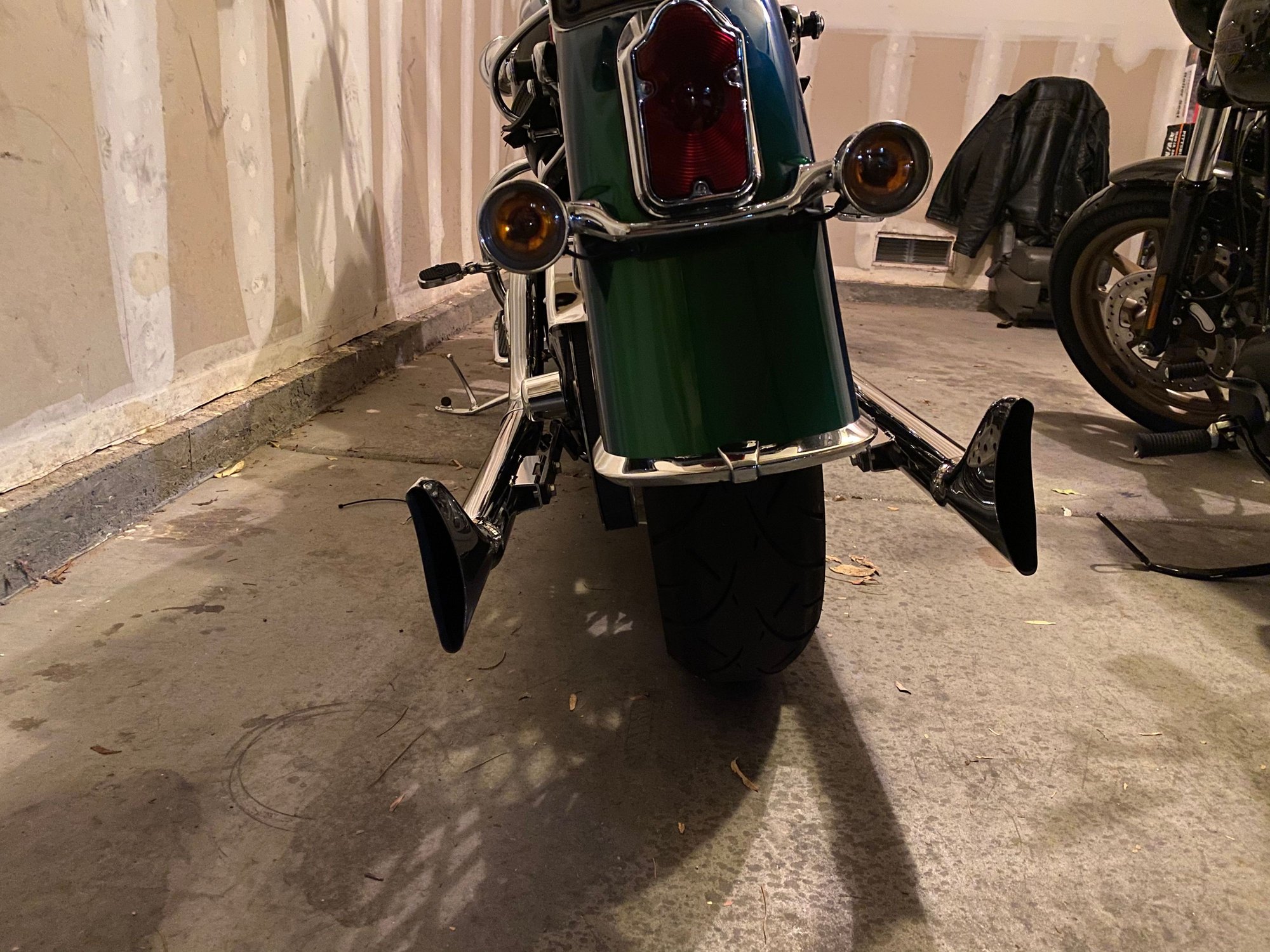

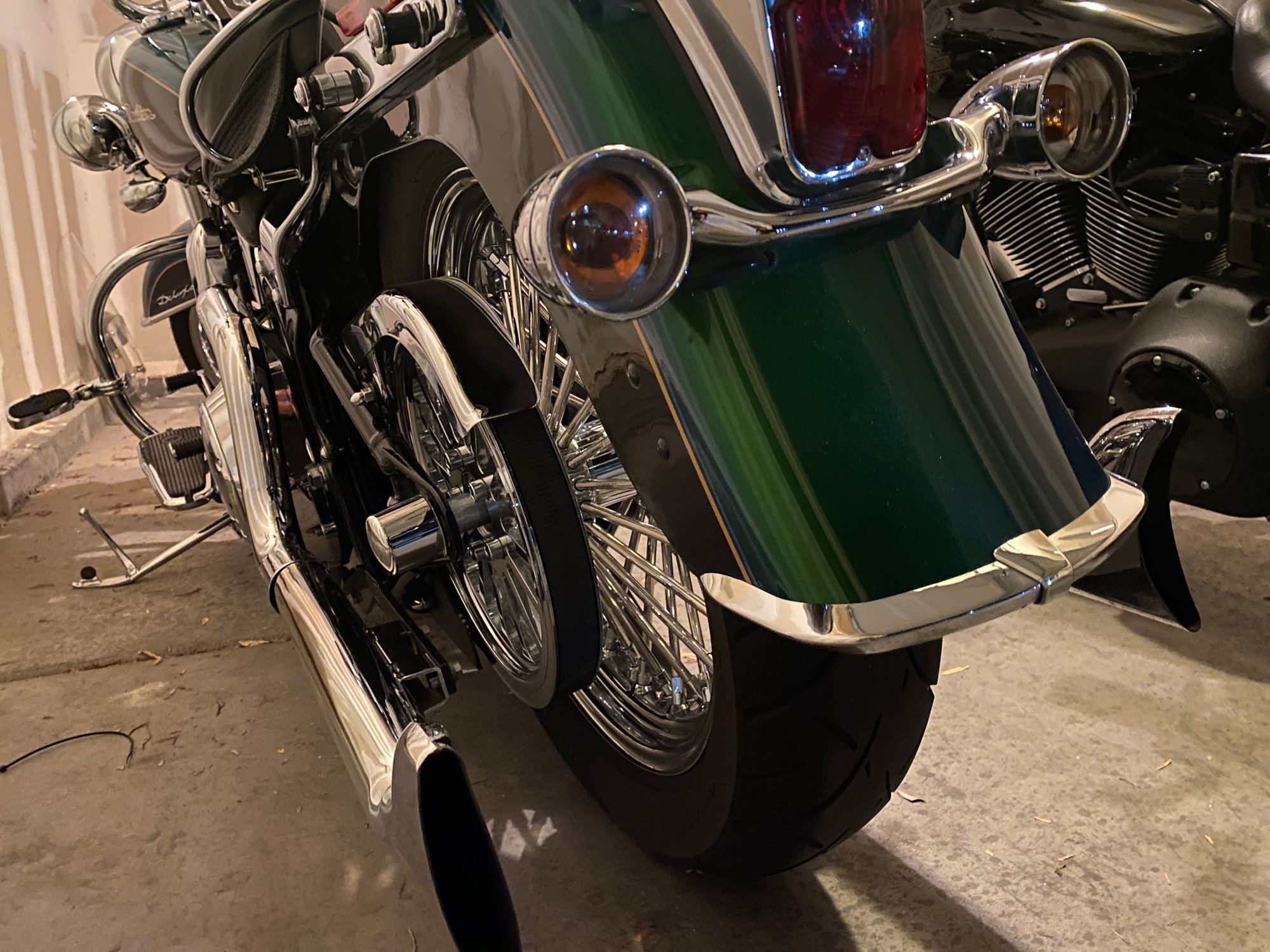

I'm running the Danny Fat 40 on the rear as well as the front. Went with the 3.5" width. You may be able to fit a 4.25 but there isn't much room. I have a 2006 deluxe. I'll snap a better picture tomorrow to show how it fills the rear fender.
I'm running a Metzeler ME 888 Marathon Ultra Motorcycle Tire Rear, 150/70-18
