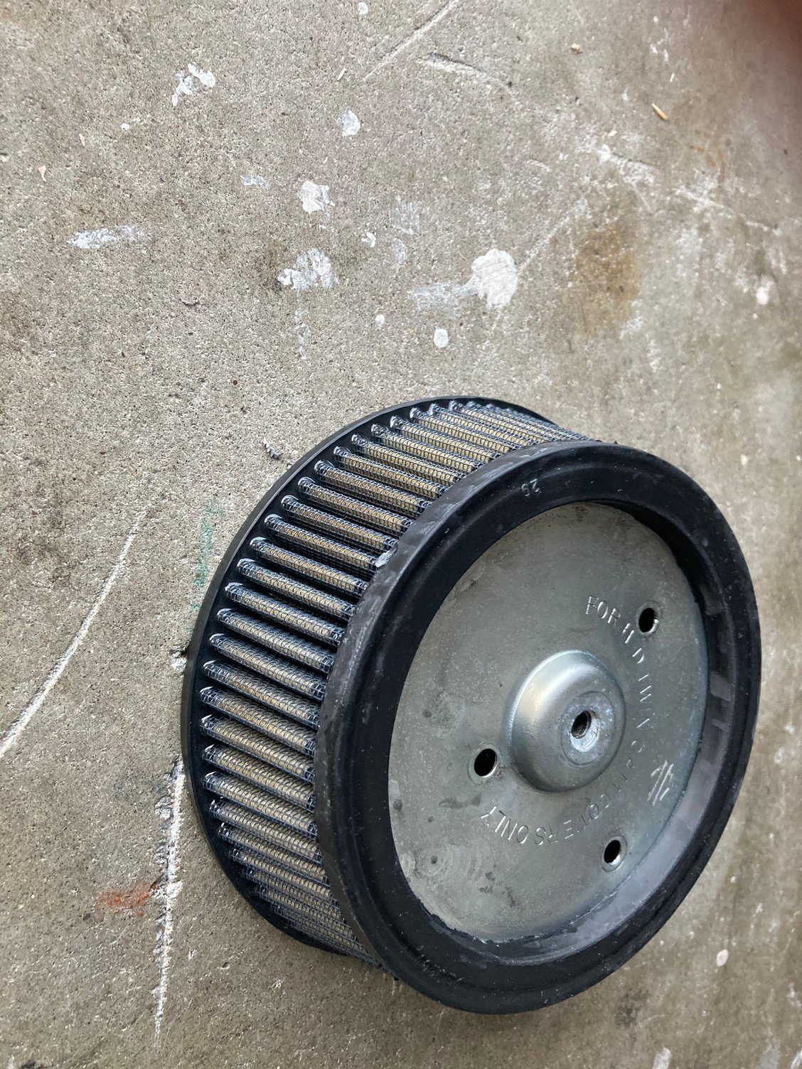

For my 03 Heritage, is this
Harley’s version of a high
flow AF, or is this the stock
one ?

Nope wrong again
i guess that is the SE
air fltr.
Well I took it off to clean
it, and it was SOAKED
with oil. It’s only been
7 or 8 mo’s. 3K mi ?
So, on these FI ... Things,
is it poss to run a cross
over (Earlier Evo style)
to eliminate the breather
pumping oil in there ?

The stock filters were paper element filters... that is one of the Screamin' Eagle Stage I (high flow) filters... They are a synthetic, washable filter element that doesn't need oil...

That is the old style SE oil wetted filter. Wash in detergent and dry. Apply oil and put a paper towel around it for a day or so to catch drips. Do not blow hard thru it. Make sure it is OK if you do not know the history. After cleaning and drying, look thru it from a dark garage with a LED light. If you see big openings, it is junk.
Also, look at the I assume throttle body (you need to add a signature line of your bike year and all letters). Any way see that little opening. All the air that is pushed in there by atmospheric pressure of about 15 psi can easily go thru a good factor OEM filter at any normal rpm that a sane person turns. All that filter does is make you think you got more power since it sounds like a Hoover Vac.
I got one just like it only new style with that front rubber is metal wrapped. Older version like yours is better. I throw a little oil on the outside occasionally. Plus it self oils pretty well anyway. K&N gave me mine under warrant. Good people. Mine had big holes in it.

Actually, that one looks like one of the earlier versions made by K&N that is meant to be oiled. The non-oilable ones have "Dry Type Element. Do Not Oil" (or something similar) stamped on the front where the other writing is (liek the one in the picture you linked).

I have to respectfully disagree... the older ones don't have the "do not oil" on them...
Here are two pics of my original synthetic air filter, that I just took. I bought the Screamin' Eagle air cleaner kit in 2003 with my 95" big bore kit. It came with the synthetic air cleaner element. As you can see, it's still in use on my 2003 Heritage...
FWIW....
My memory isn't what it used to be... but... I don't remember the MoCo selling an oiled element air filter back in the early days of the twin cam.... I bought a couple "Screamin Eagle high flow air filter kits" and they all had the synthetic, non-oiled filter elements... I wasn't looking to avoid the oiled elements at that time, I was just getting a high flow element from HD and that's what the MoCo had....as late as May 2012, when I bought the "SE Stage I A/C #29260-08" for my 2012 Limited, they came from the MoCo with the synthetic, non-oiled elements... I believe it was sometime after 2012 that the MoCo made it's contract with K&N to provide them with oiled filter elements for their high flow kits... I could be wrong, that's just how it worked for me...

That looks like a filter meant to be oiled. When I bought Reaper in 2005, I had the dealership do the "Stage 1" which included the Screamin Eagle Air filter kit. It came with an HD branded K&N filter, that was meant to be oiled, that looked exactly like the one in your pics. That was the kit for the first few years, before they went to the non-oiled filter, which had a blue coloured filter media (at first, anyway), and said "do not oil" on it. I'm no expert, but I've never seen a non-oilable filter (from HD, anyway) that didn't say "do not oil" on it.

Don't know what to say... it's a synthetic filter that does not need oil...
I have had a few of them and they look the same as the one in the pic... I did recently buy a couple new ones (within the last year), just to have them because I like them and heard they were being discontinued. The newer ones have the "do not oil" on them, but the filter elements look the exact same...
