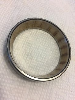

Here`s a pic of the steering neck bearings from my `89 Softail, at 135,000 miles, they were only repacked once (at about 80,000 miles )
I couldn`t feel any damage, but obviously they failed the visual inspection, so into the scrap they went.

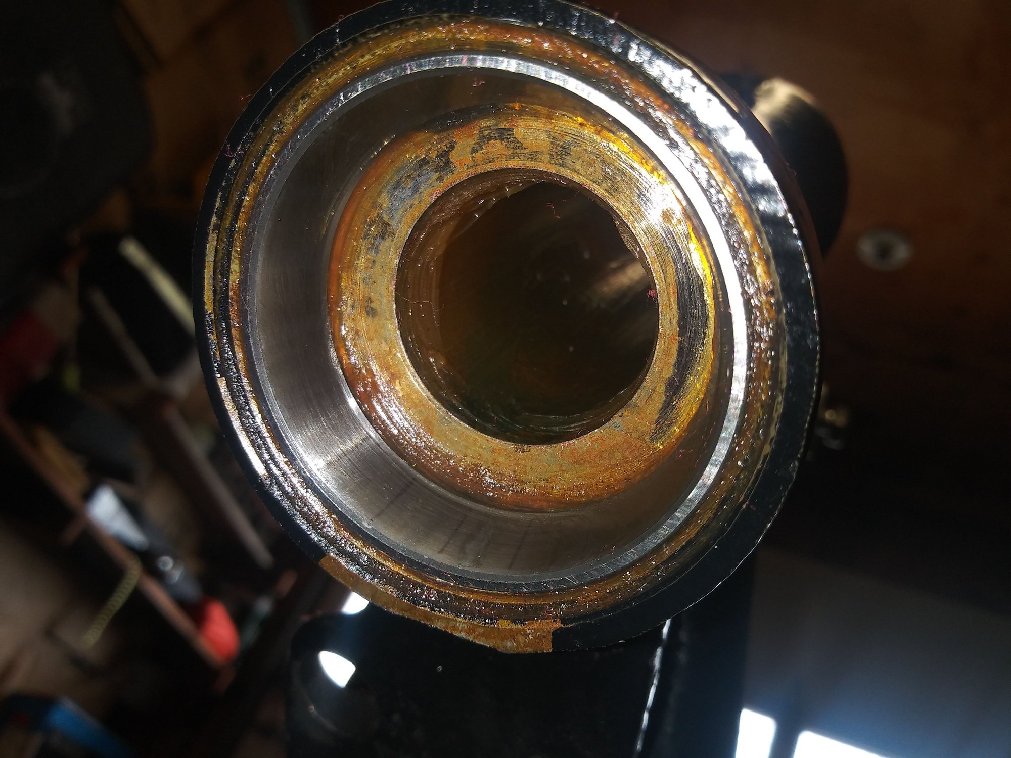

This is as far as I have gotten so far. My son came out and asked me to help with his car so bike put on back burner for now. To me the races look good. Bearings need to be cleaned up and checked over. What's a good way to get all of the old grease out? Thought about just shooting with brake clean but figured I'd better ask before I do something.
