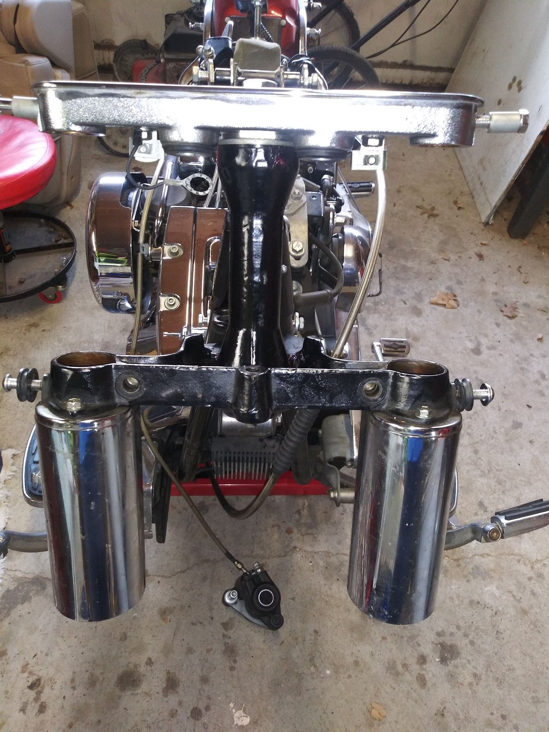

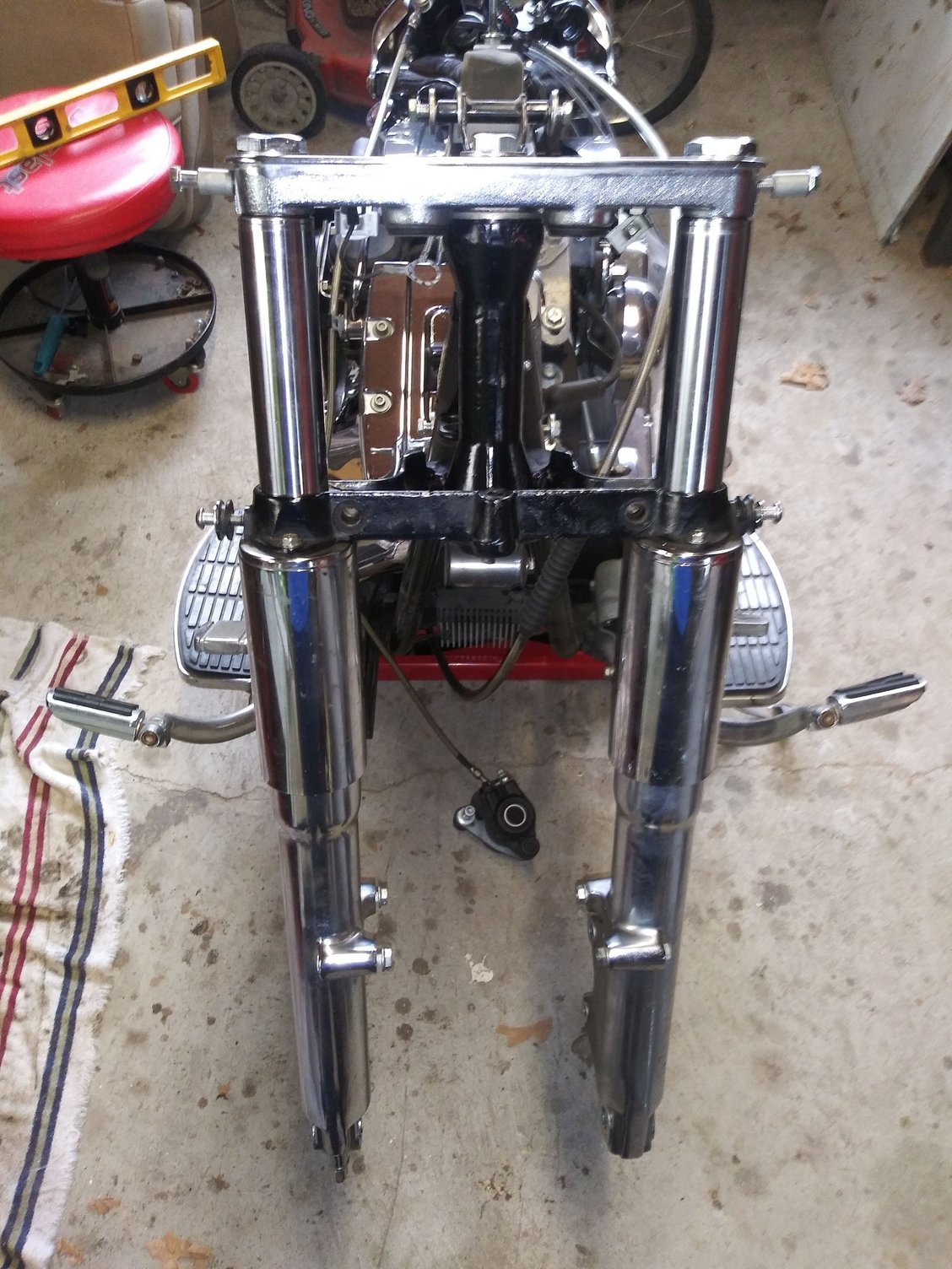

This is what i found when I pulled front end apart looking for a bad seal.
Bearings repacked and going back together.
As far as I've gotten so far.
It has been a learning experience for me. Now then I just got to get it finished. Thanks for the help so far.

Get the caliper up off the floor and tie wrap it up out of harms way.
Old Mar 11, 2021 | 05:45 PM
manderson17's Avatar
manderson17
Joined: Nov 2020
Posts: 48
Likes: 21
From: indiana
It's up off the floor now.
