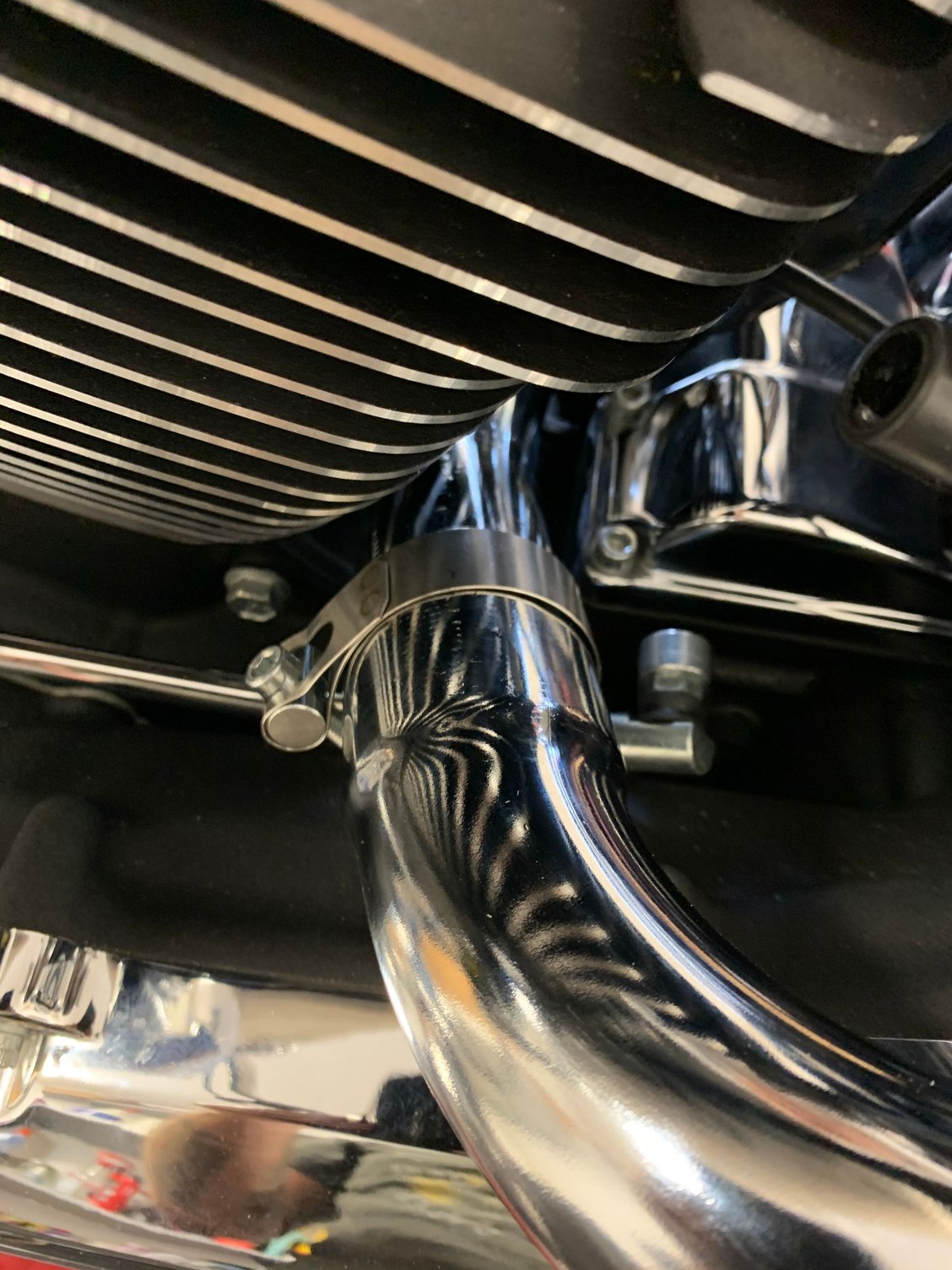

Hi Guys who have installed the Samson duals, I have read (extensively it seems) of the issues that can crop up installing that rear pipe, I have to say installing the rest of the system is a breeze, and have bumped into similar issues.
It seems in some level of rotation into the head it is just about impossible to get a socket over the 1/2” flange nut, ever with a !/4” drive swivel socket, having tried on just this for a couple of hours yesterday I am about to give up for plan B.
I am going to bend an open 1/2” Socket 45 degrees at around 2” and attempt tightening from the left side.
Samson Instructions suggest tightening back to front on the left side I think, any of you guys get this rear head pipe aligned first and tightened then work away - ? , after all the tail pipe is pretty limited in movement on the bracket so Im guessing key positioning occurs in that rear connection on the mid pipe...?
Cheers all.

Im thinking of all the Samson installations I cannot locate photos of the install anywhere.....for example I trying to establish if the location of the mid pipe over the primary and the connection to the head pipe are in a location o theres might be familiar with.....for Samson to load up a few photographs of a correct install is asking too much?
Any observations appreciated chaps.

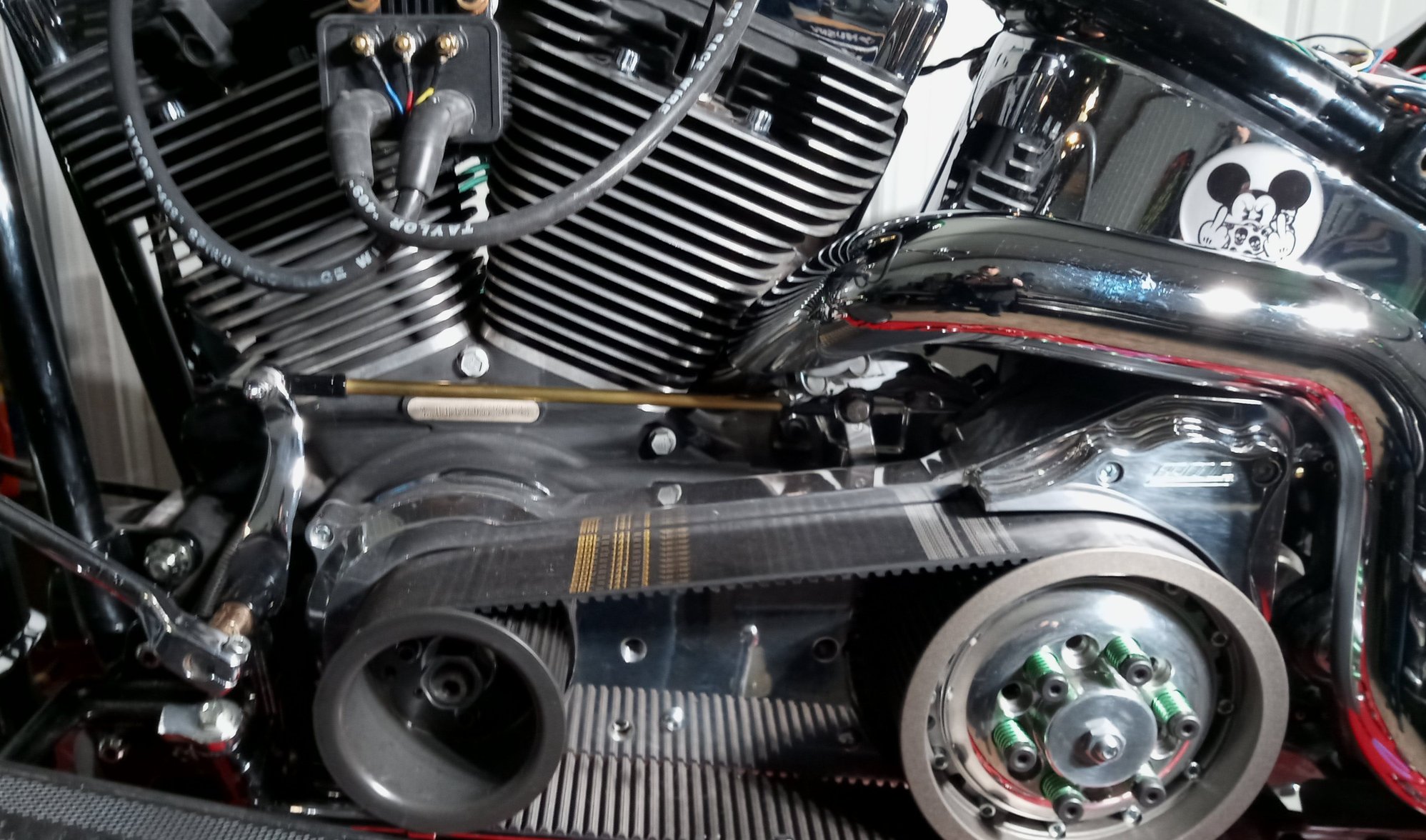

If you're questioning the shift rod at close proximity with the pipes, I have Freedom Performance pipes and mine are extremely close also but works fine.

Originally Posted by royston
So I wasn't able to edit the post I left so added here (sorry admins),
I had similar issues when I installed my Samsons. The way that I solved it was basically just moving it around against the head until I saw that it was going to clear and tightened it there. There's one flange bolt that is a huge pain in the *** to tighten. I used an extension and a crawfoot open ended socket to be able to tighten that sucker.
Good luck bro, that pipe is a pain in the *** but once it's in, it's all worth it!
