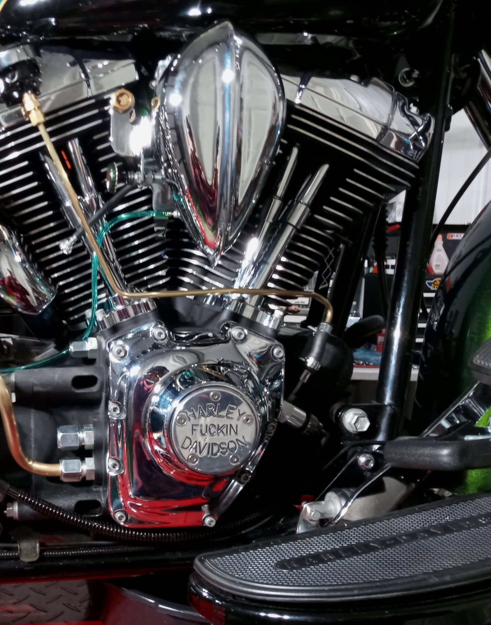

I removed everything EFI and installed a Mikuni HSR42 carb on a 06 Deluxe 88. You can see the idle adjustment black flex hose with a chrome **** to the left of the A/C. Easy to adjust anytime.
