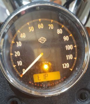

Does the speedo say "Tip" in the odometer display, like this?
Cheers!
Old May 28, 2021 | 12:01 PM
Yeagle1974's Avatar
Yeagle1974
Stage III
Joined: May 2021
Posts: 3
From: PA
No sir
