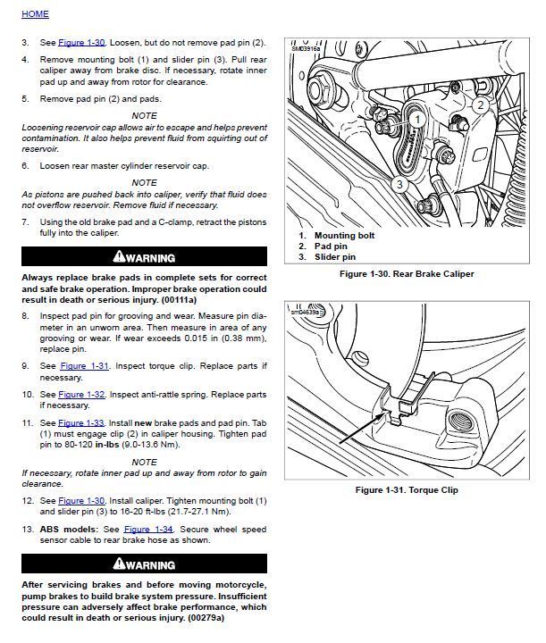

I have a 2016 Slim and if your set up is the same you will struggle to get the Mounting bolt (No1) and Slider Pin (No3) out or even loose as they are not a bolt with a hex head but have an internal Torx to unscrew it, you have no real access to get a tool in unless you remove the mufflers!

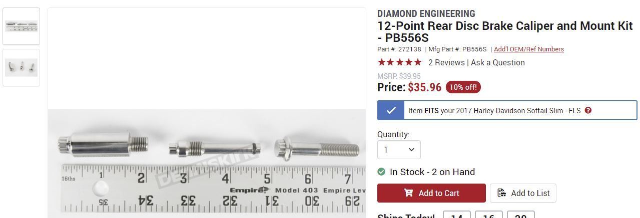

I replaced mine with a Diamond engineering pin kit which uses 12 point heads and can be accesses and removed without the mufflers coming off and also looks shiny....
