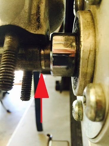

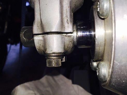

The step is here, this is where the axle goes against the spacer,
Just remove the axle cap and take a look...
Here`s some pics from an Evo Softail:
Step on axle, not pulled together yet.
Axle pulled in and torqued, step is now against the spacer.
Axle torqued, cap installed.

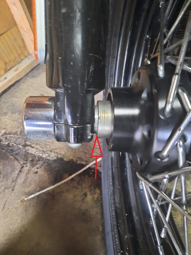

I was referring to this

Pretty sure that's what Dan89FLSTC was showing in his pics with the slider cap removed... One pic with the step before being pulled in by the torque, and another with the step up against the spacer after torqued. Both before the cap was replaced..
