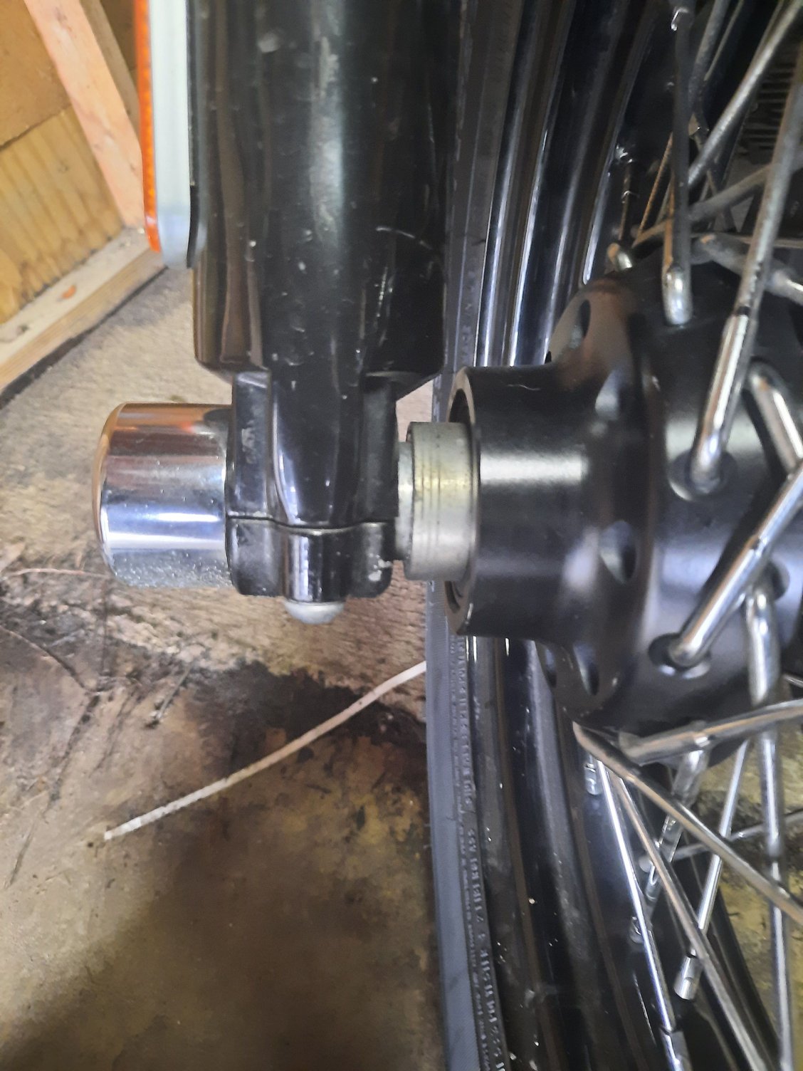

I just had my front tire replaced and noticed this gap between the axle and fork. Is this normal?
The bike is a 2016 Softail Slim S.

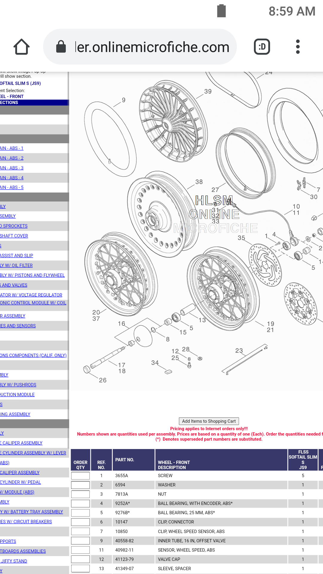

A gap like that will allow side to side movement of the front wheel and put pressure on the rotor/caliper. What does the other side look like and is the front wheel centered. I would lift the front end off the ground and see if there is any lateral movement. Don't forget to pull the caliper off of the mount or that will hold the wheel in place. If they reversed the spacers it would just move the wheel off center. Its almost as if they used a spacer off of a different bike.

Thanks for the quick reply. The wheel is perfectly centered and the other side has no gap at all so it would be unlikely any movement is possible but obviously if this is not correct I need to have it fixed. Any other Slim owners have any pics they can share?

There is a step on the axle, it is pressing against the spacer.
To ease your mind, loosen the axle nut, remove the cap, bump the axle a little bit toward the right side of bike, you will see the step.
Reassemble per the service manual (torque axle nut, then install cap and torque nuts).
It just made sense after reading this and looking at the parts fiche. That bike would of had a salad bowl on that side of the front wheel, with a step in the axle it would give it the proper space so it wouldn't bind. It just looks wrong without the cover. I always thought the bowl had a flat bottom so it wouldn't touch the forks but it seems the axle is stepped to keep a proper gap.

Some of you are not reading that illustrated parts diagram correctly...
The mini hubcap may be shown in the illustration, but if you try to find detail 16 on the parts list, you will see that it is not listed, meaning it is not used on the 2016 Softail Slim S.
