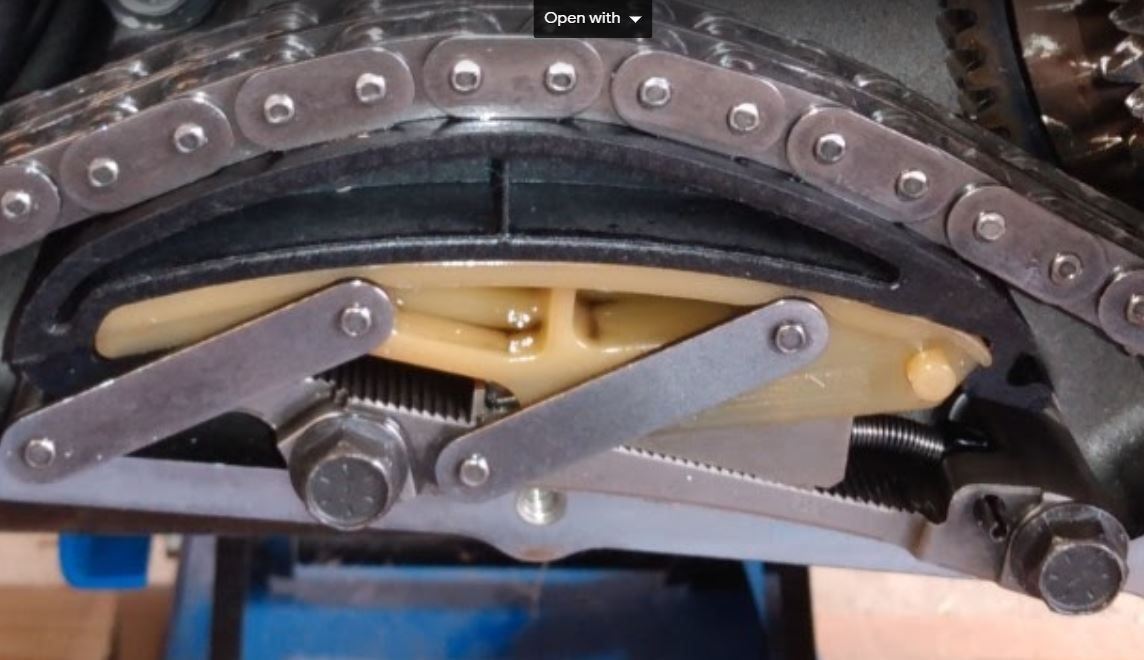

Primary tensioner
This is my tensioner with added shoe that came with the Darkhorse MOW

Originally Posted by RHD51
Primary tensioner
That certainly looks like the "B" tensioner.... Like I said they were far less problematic than the "A" version, but they weren't perfect.....
If you are downshifting on an engine that is at operating temperature, you should be fine... not your fault if the tensioner is making things too tight...
Could be time for a new, and possibly different, tensioner...
Good luck with your repair... Let us know how it turns out...
