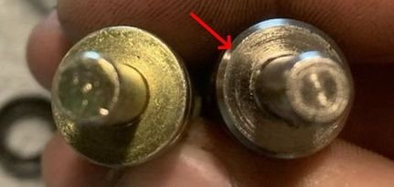

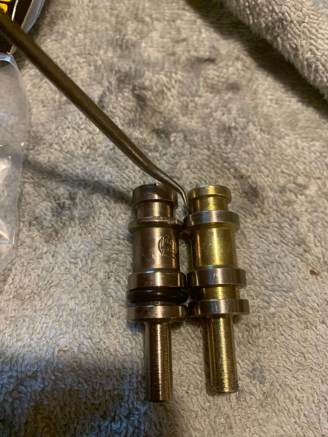

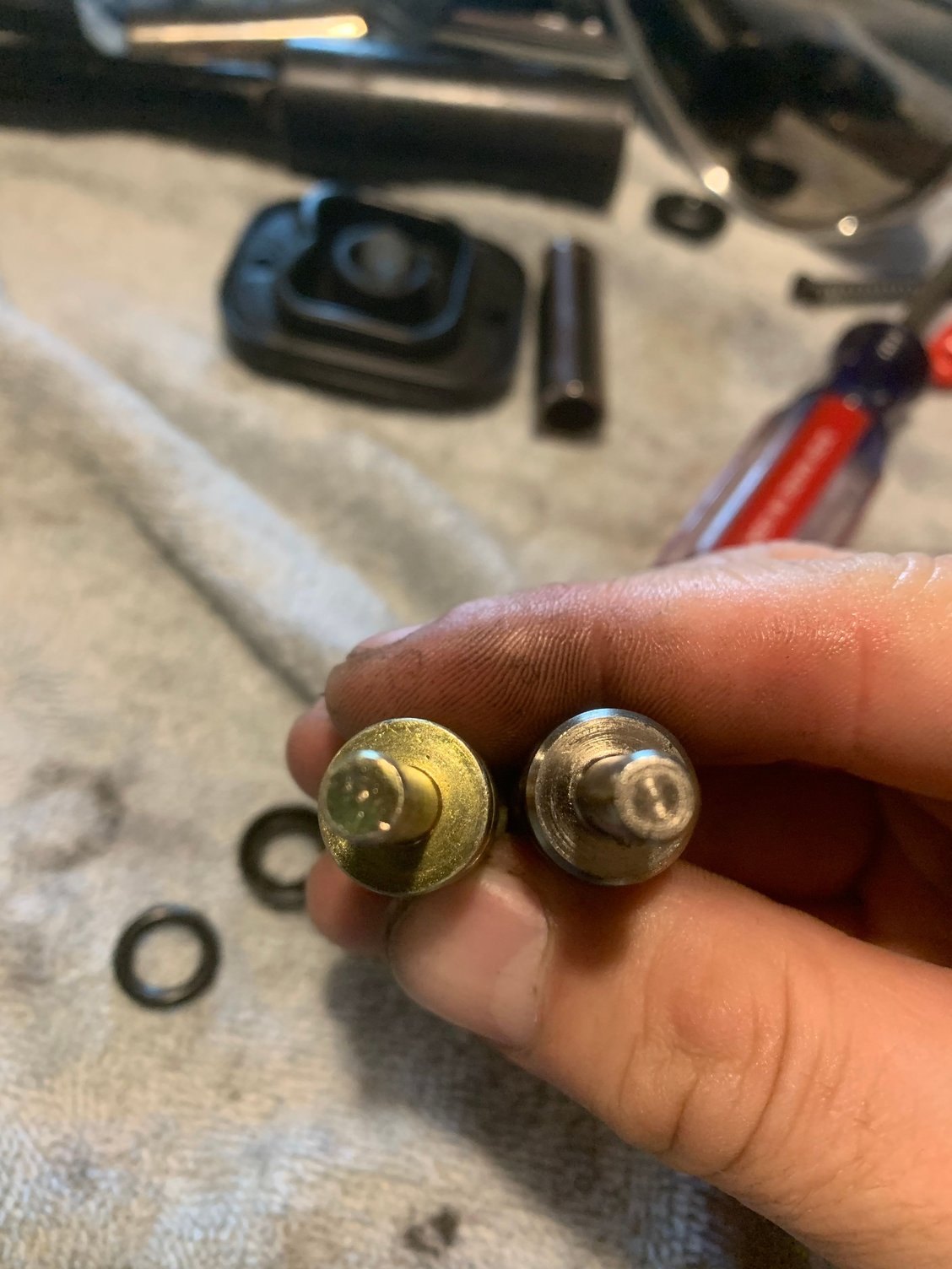

2004 softail duce . I have a 9/16 from master cylinder , order a rebuild kit that comes with the new plunger / piston , seals . First one I get the piston won’t fit in the bore , maybe a miss packaged part , get a new one sent to me through J&P no cost . 2nd one, no dice . Tried putting the seals on the piston that fits, seals too big.
it’s stamped 9/16 on the master, I ordered a 9/16 rebuild kit but doesn’t fit. Non of it is making sense anymore . Can anyone point me in the right direction

seals off the new piston don’t fit everything is too big for the bore size
who is the manufacturer
one on the right has a beveled edge - one on left does not (?)

not sure it’s a generic JP part number 29-032 and that bevel is to the outside it goes from this end in, the gold one is the replacement it’s like a few thousands too big for the bore , seals seem they won’t swap over either

yea I’m thinking it’s got to be metric . 2 of the same rebuild kits (bikers choice) and the plungers are too big even if you take the seals off the plunger it won’t fit into the bore

Let's try this again, use the OLD piston with the new seals, f**k the new one toss it, it's shorter anyway.
